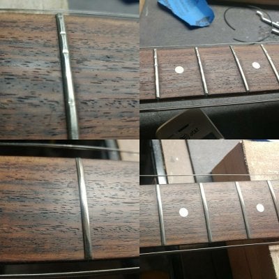

Found a pic from a job like this I did a while back. You can see the fretwear before and after.
A lot of times, wear looks worse than it is in reality. You will lose a few thousandths of an inch in fret height, but not typically much more than that.
I've measured hundreds if not thousands of frets, and I always do with digital calipers as a precaution to make sure I don't remove too much. You would be shocked at how much dust comes off the frets when you sand or file off only .001" or .002". If you're gonna try a level and crown yourself, I would absolutely recommend that you get a pair of the Stewmac digital calipers that are notched out for measuring fret height.
(link removed)
They look nicer than the older version that I have as well! Gotta love tools that get updated after you buy them :p
What you do is zero out the calipers on the fretboard, by pushing the probe down until it touches the board. I usually find that on my calipers, the probe is level with the bottom of the tool at about .079".
Then when you put the notch over the frets, with the probe flush with the bottom of your calipers, it'll push the probe back up inside the caliper a certain amount. That certain amount is your fret height.
It will be in a negative reading. For example, -.042". Short and sweet and if you take frequent measurements you will save yourself a lotta nightmares. You'll also learn a lot because you'll know exactly how many thousandths you're taking off as you work.
Personally, my cutoff is a fret height of around .035". I would never use frets that are that height when they're new, but if you're trying to extend the life of your current frets, that's OK. I can play on frets that low without too much issue, but frets around .048" to .050" feel infinitely better to my hand. Especially with bending and vibrato which I do a whole lot of.
If you're not huge on bending and vibrato, fret height matters a whole lot less.
Leveling and crowning does involve some degree of investment. Personally I only level under real string tension using a custom tool of my own design. The method Ron has up works just fine as well and is much more readily accessible.
However you do it, especially as a beginner, I again wholeheartedly recommend those calipers. Measure your current fret height and keep track of how much material you're removing as you go.
My recommendation is still to go for a SS or EVO wire refret, unless you want to learn how to do your own fretwork, or you are OK with paying for a level and crown now and eventually needing to pay for a full refret later.
