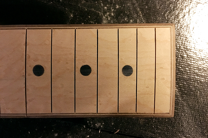

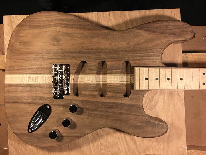

So I'm working on this walnut and maple Strat project. Everything is going fairly smoothly. But I ran into problems with the frets. And I'm hoping I could get some advice on how best to approach this issue.
I decided to do a three-ply Walnut/Maple/Walnut binding.
I bent the frets to a slightly tighter radius than the 9.5 inch fret board.

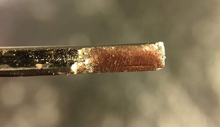

I clipped tang.
Then filed the remaining ridge.

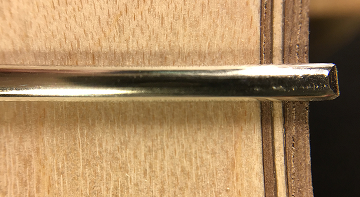

But here is where I ran into some trouble. When I tried to seat the frets, the edges did not sit flush to the binding.
So here are my questions:
Any recommendations for gluing binding (one problem might be glue getting into the fret slots)?
Does anyone have a special trick for clipping the fret tang and filing the ridge?
Any thoughts on the best way to hammer frets without a tang on the edges?
Thanks in advance,
Steve in NH

Before gluing on the binding, I fill the slots with plastic strips, cut from a lid to a coffee can or whatever, plane them flush top and sides and glue away, pick them out after when you're ready to fret. A Stewmac fret nipper is perfect for frets, but in a pinch you can nip and file - it looks like you might have filed it beyond flush in the photo? Lastly, I overbend (slightly) the fret ends, so when you tap the middle down, they stay down, sort of by spring action. You shouldn't have to hammer the un-tanged ends really at all this way, if you follow me? You've got a ding there under the unsupported end from hammering it, hope you can swell or sand it off and give it another go, good luck!

Just a theory, but is it possible that the nipping and subsequent filing reduced the curvature you'd bent into the frets? Perhaps you might try reversing those operations: nip and file, then bend. If possible.
Failing that, over bending the ends should work for getting them flush, though leveling might be a headache later.

I did use fret nippers. But they didn't take the tang clean off. So I had to follow with the file. I think Picton may be on to something with the bending against the radius while filling. Does anyone have a method of filing they like to follow? Obviously, I realize that it's best to file lightly and check frequently. But I did notice that it was difficult to file perfectly parallel to the fret. I did notice a slight angle while doing the first couple of frets.
Picton, I used a fret bender and fed the whole 18 inches through at once. So I wasn't bending each individual fret before seating them.
When bending frets tighter than the radius, do you guys find it bet to have a consistent curve, or would it work better to have a slightly sharper bend at the center of each fret before hammering? (I'm thinking something that resembles more of a boomerang shape.)

I used a dremel and file for the tangs and had to re-do a few where I filed too much off the tang.

I want to thank everyone for your feedback. Your help along with the advice from someone at Stewart MacDonald really did the trick. I combined glueing the frets with a fret press. The frets popped right into place without gaps. Here's a few photos.
Thanks again. I knew you guys would come through for me.
-david
