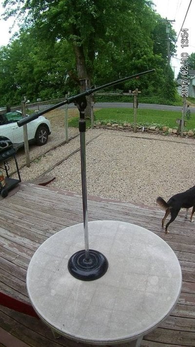

The one thing you might want to get is a proper mic stand. If you use a tabletop type it's going to be really hard to keep the early reflections from the desk from colouring the tone, plus it's going to be harder to adjust it into a position where you can sing or play acoustic instruments in a comfortable and natural posture. That will probably hurt your results. Just a thought.

This is EXACTLY why I came here to ask my dumb questions. I didn't even consider that. What is a 'proper' mic stand? There's one with a boom on it on CL right now for $20. I thought about hitting that but I don't know anything about mic stands.
Is that what you mean?

I think you'll be set once you secure a floor mounted boom stand. Dont be afraid of cutting guitar tracks with compression and overdrive from your boss unit though. If you dont like em, dump em!
