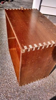

I just built my first speaker cabinet, using a $10 new set of Craftsman dado blades. The wood is recycled 11.5" pine shelves from a bookcase removed from my rental house. I have zero experience with precision woodworking, and my $100 table saw has many issues and got only terrible reviews when introduced.

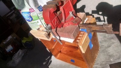

First, is there a trick to avoid having to cut some boards from inside to outside faces? I got very clean cuts when cutting the outside of the boards inward, but they were raggy when going from inside to outside, with some chip out. See pic 3. However, it was the only way I knew to allow me to get the fingers matching on each end of the board.
Second, I got some joints with some voids, even when clamped down as tightly as I could with the limited equipment I have access to. Can/should these gaps be filled with wood filler before sanding the joints down? I did make a sled for cutting the fingers.
Last, is it customary to round over the fingers, and is there are recommended technique when the joints are not quite perfectly flush and there are some low spots?
Don't go too hard on me for not getting everything perfect yet still going ahead and gluing it up! It does seem to be very sturdy.
I tried hard to get all of the pieces to have matching grain, and that succeeded pretty well.
The speaker will be a 1960s 15" Heppner alnico, I think from a Hammond organ. Only $15 from OfferUp.

I'm still learning all this wood working stuff myself.
Are you planning to cover the cab, or leave it natural? If covering I would fill all your gaps and voids with good wood putty, then sand it all smooth.
If you're wanting a natural finish, I'll have to defer to more knowledgeable wood workers. You might be able to get colour matching filler, but some of those voids snd gaps are deep, and the filler would be obvious under varnish or oil etc.

Thanks for the reply! I want to leave it natural, and will leave a lot of the dings and scratches, and not sand it all down and refinish. I do think I want to round over the joints.
The really loose fitting joints in pic 2 was during a dry fit. Pic 4 is how it looks glued up, and many of the gaps are much smaller, but the fingers are not perfectly flush, so I will have to take a fair amount ( maybe 1/16") off to round it over. Then I was going to use Mohawk products to touch up the exposed fresh wood, after filling and sanding, of course.

Yep, had a closer look at pic 4. If you sanded the proverbial out of it, you could make it flush enough to round over. Maybe even plane the sides and then sand?

The tear out can be minimized vy using a sacrificial backing board held tight against the face as the blade exits. Too late for that now. Also, you can cut them all form the same side, you just have to stagger the first joint. In the future, cut your tails a hair too long (by raising your blade) and sand back to flush.
I have been a carpenter for a long time. Finding a filler to match is a pain in the rear. Especially sun darkened wood like you have there. You can try painting it to match, or try stains mixed into the filler. But, I'd suggest testing on one of your cutoffs first.
I would also suggest that matching the finish on the corners to the existing finish might be kinda difficult as well. Again, you can use stains or dyes to get a color match. But, I would wager it would be faster to sand the whole thing down a touch and finishing it all in the same finish as the original.
Another thing you could do is cut thin slivers of matching wood the size of the gaps in the ends of your tails and glue them on. That's probably your best bet. Once the glue is set, round over your corners. Just make sure you are using cutoffs that show the end gap, or your tail ends will have the wrong grain...

Thanks to all of you for the suggestions. I'll know next time to use a backing board, and will remake my sled with a 3/4" plywood face so it is flatter than my current one, for better clamping. I had set the blade to make the cuts deeper than the board, but the blade has no lock on my cheapo saw and I think maybe it drifted down from my original setting due to vibration. I'm probably going to leave my gaps as is, the piece will be a reminder that I have a lot more to learn. I may even abandon trying to round over.
I did find that I had some movement in my sled. My Hitachi saw has 9/16" slots for the miter gauge and sled, and I didn't have any stock of that width handy for the sled, so I just used something narrower and biased the 2 runners towards each other. Now I can see how important it is to improve that and take out the 1/16" or so movement that I could detect. Maybe also buy a pair of quick release clamps so I can move the work piece more quickly to speed up the process. Pics of my sled below.
The scribing technique sounds very useful and I'll implement that next time too. Does it also help to tape the side of the work piece on the tear-out side?

I'm sure scribing the lines would help with blowout, but that seems like a lot of tedious work to me. But then again, I'm lazy. I have used tape before. Maybe it helped minimize tearout a bit, maybe, but not nearly as well as a thin piece of press board.
I like your sled but it's important to get any backlash or movement out of the equation. I'd consider removing those risers from the bottom and putting them on the top and then screwing another horizontal piece of wood to them. Then you can dado through the whole width of the jig if you want and it will hold together fine. Just let flat surface of the jig ride on the channel guides by themselves. Might also screw in a larger face plate too to make clamping and holding the work piece easier. I think you've got a perfectly useable jig there.
Then take a bunch of scrap wood that is the same thickness as your cabinet and start making test cuts. Like I said, its time consuming.
