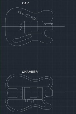

Good afternoon everyone! I thought I would try to document my dad and I's second tele style build. This is actually our first full-fledged guitar project on his new CNC machine he got back in December, so it has taken a few months of trial and error in both design and build to get to this comfortable and 'proficient' so to speak.
I've never owned an electric guitar with humbuckers, much less a '72 Thinline with WRHBs, but I was drawn to building one to break this trend and try something new. I began by searching through Fender-Ish guitar plans and choosing my desired plan.
I imported the PDF file into AutoCAD for some fine tuning of the vectors and then into VCarve for the CNC.

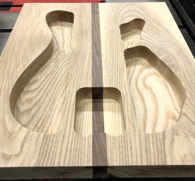

I don't think we had the drop top ready at this point, but we began with the pocket tool paths for the chambers.

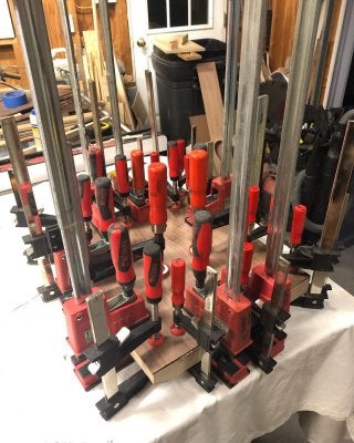

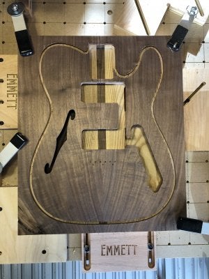

Next, we glued the walnut drop (0.25" thick) to the chambered ash body (1.5" thick). Make sure BEFORE you glue your drop top on that you mark on your body somewhere which end is the neck end and which is the bottom. This way your chamber cavities correspond correctly with your F hole and control cavitities once you glue your drop top and begin to rout.
The current body blank weight at this stage was 8lbs 14oz.
Next we routed out the body profile, neck pocket, pickup cavity, F hole, and control cavity, as well as the string holes and bridge mount holes (both accurately spaced to fit the Callaham Vintage Hardtail bridge), as well as a binding channel. The binding channel was created by offsetting the body profile vector by the thickness of the binding.
This dropped the weight a little over a pound to 7lbs 11.75oz.

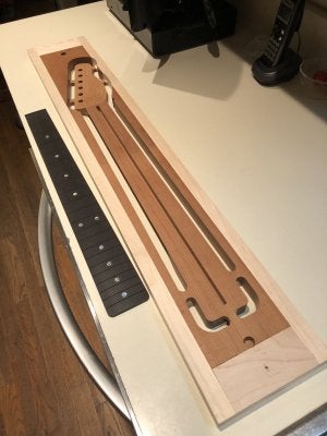

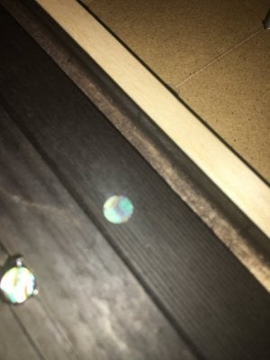

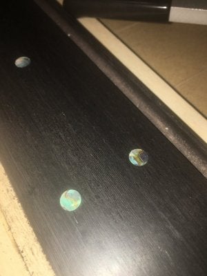

It’s been a while since I’ve posted anything regarding this build, but we are finally starting to make progress again. After months of fighting and losing with VCarve Pro to produce the neck I designed in Fusion 360, I had a friend of mine machine the neck using his ShopSabre CNC. We were able to produce the fretboard on our machine, though!
I’m extremely pleased with the fit of the abalone pearl fret dots!
