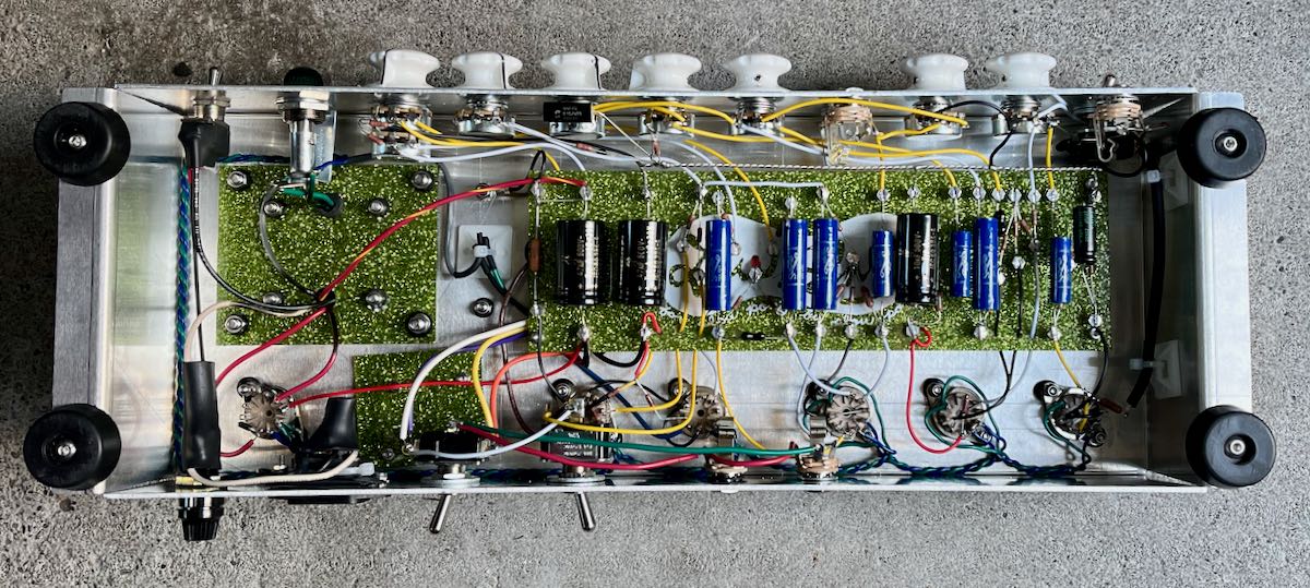

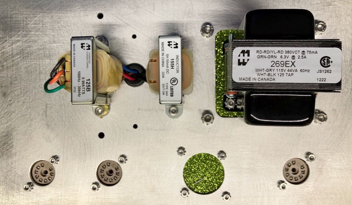

I used a Marshall 18 watt chassis and used the extra holes around back to add a few things: added a 4/8 ohm impedance selector and a 3-way NFB selector, using Rob's suggested 15K value and adding a 5.25K option (2.8x less)... though again, see more below.

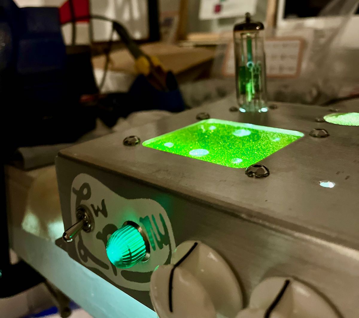

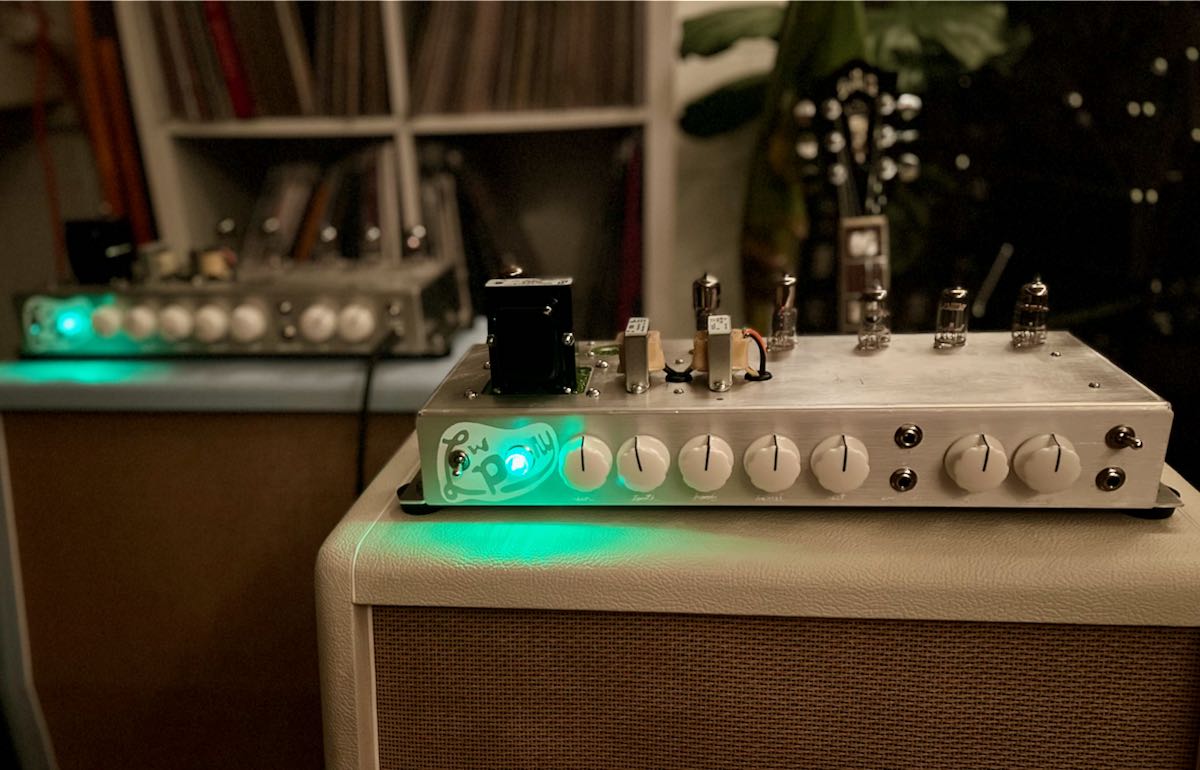

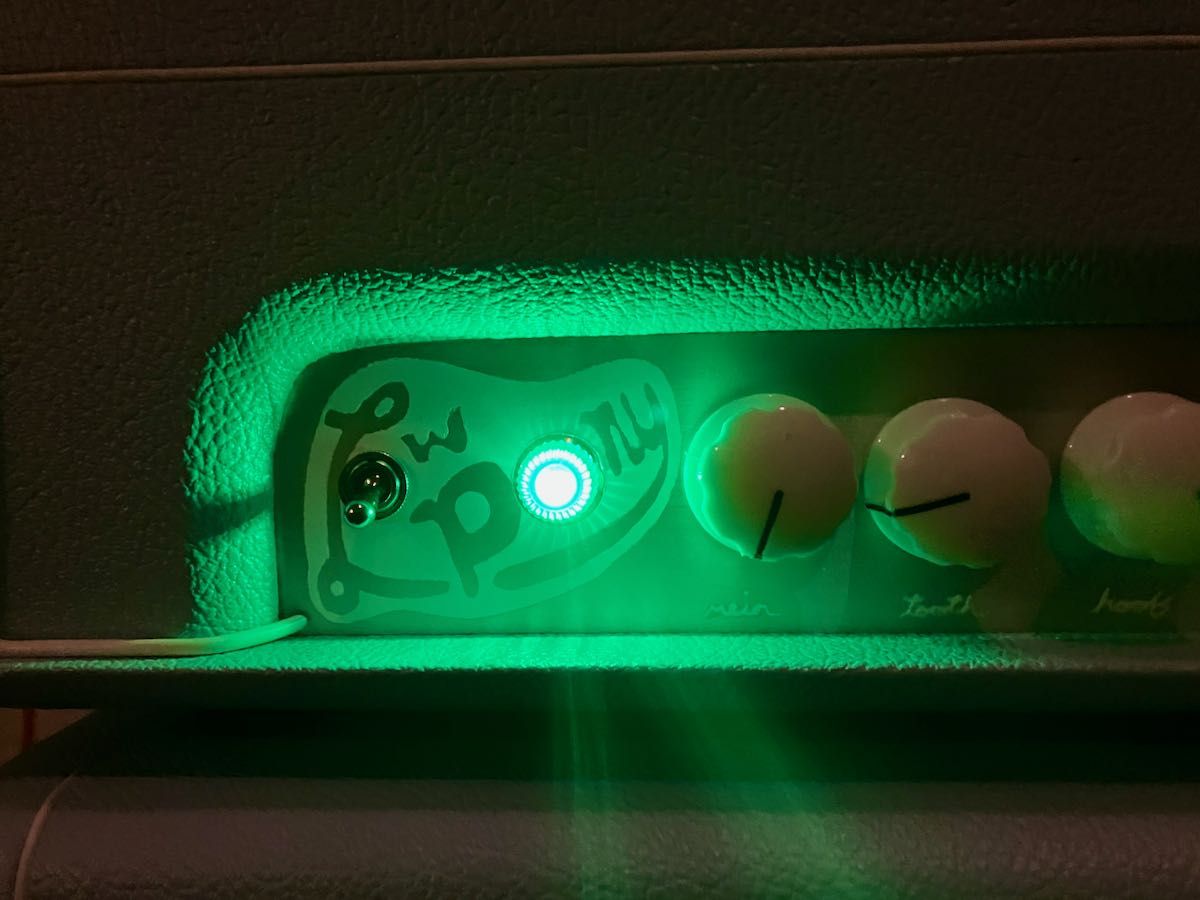

Here are some shots of my build. As you can see, I went a bit crazy with cute details, like the sparkly plexiglass boards, and all the silkscreening everywhere (I spent more time on silk screening and case design than anything else!).

The first was the raw/mid knob (100K audio taper pot substituted for the normal mids pot). Turning it up all the way didn't entirely remove the tone stack as intended. I thought about this some more... and obviously in retrospect, that's because @King Fan used a "tail resistor" in his implementation (see layout diagram here), which meant the raw/mid wouldn't even entirely dial out the tone stack. So I just linked around it (see above, if you have eagle eyes!) and it solved it. I'll go back and make it pretty when I solve the one remaining issue...
Namely: it still seems like my bass control isn't working. At least, I can't hear it doing anything. It's now built exactly like @King Fan's layout above, except without the tail resistor from the raw/mid pot. It's also exactly like @robrob's original layout, if you sub in a 100KA mid pot. Maybe the bass knob is just really subtle? (Note that I put my bass knob physically next to the presence pot, so that it would go in order, treble, mid, bass.)

I had local hero Derrick Bell of Veteran Guitar Cabinets make me beautiful matching cabinets for the two builds, both with slanted vertical 2x12s closed back speaker cabs. One is loaded with a vintage P12Q and a vintage C12N, and it sounds great... but the REALLY great sounding cab has two Celestion Century Vintage, a speaker I love and stockpiled when they were discontinued and being blown out. They're a PERFECT match for this amp: loud enough to make 4 watts sound like 15 when needed, with lots of low end too, and with a delicate softness reminiscent of vintage alnico speakers. I'm going to swap two more Century Vintages from my stash into the other cab.
