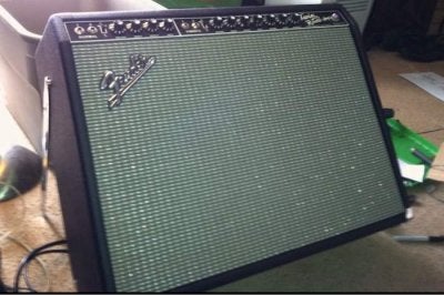

Here is my 1969 Twin Reverb. It has the wrong grill cloth, no trim, no foot switch, and still has the 2 prong plug. Even so, it sounds amazing! I am looking to sell it (or trade it) so I can get something smaller, since I don't really play outside of my house anymore. My question to you all is: Do you think I would make a profit if I put money into the cosmetics, or should I just sell it as-is? I'm not using this forum as ad space, just wondering what condition is best for selling. Your input will be very helpful!
