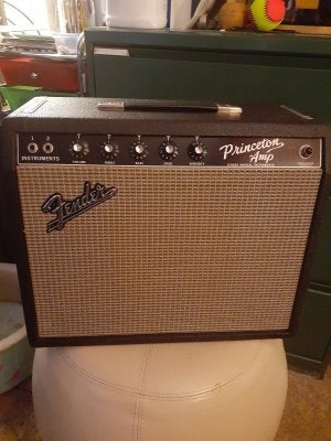

I found myself at an estate sale last week, rummaging through old packed boxes,since long forgotten. In the middle of these stacked boxes I found an old fender amp. Very clean considering the age, however, some tale tale signs that this is infact and older amp. It even smells old.
What i discovered (from what I have learned so far) is a 1966 Fender princeton amp. I know that they are worth some money and after posting it online to sell, a gentleman suggested that its too clean to be a 66 princeton and quite possible its a reissue.
Doing more research, i have learned not to go by the tube chart on the inside, even though the paper has browned over the years as paper does. Still, the tube chart has been proven not to be a reliable source of information.
The power supply is stamped :125P1B-606-5-42.
I will admit it, i don't know jack about this and/or how to confirm its authenticity, which is why I am reaching out to the experts of this forum.
If anyone has any information on this amp,i would like to hear from you..

125P1B is the correct code for a Princeton power transformer
606 is Schumacher, the manufacturer’s code
5 is 1965
42 is 42nd week of year
You most likely have a 1966 Princeton. Congratulations, thats one heck of a find!
Any pictures?
Lowerleftcoast
Dec 30, 2019
7,460
california
The transformers and other parts have date stamps. The as CWP1026 sited it is probably a '66 but the transformer could be from '75. If you pull the chassis it will be obvious to the trained eye which year.
The OL on the tube chart indicates Dec 1965
CWP0126
Apr 2, 2016
377
Florida
Does the #4 stamped on the tube chart have any significance such as a production #?
The #4 indicates an early production run, but the OL is your date code. That translates to December of 1965.
(link removed)
That is a beautiful amp, and it is not a reissue. Again, congratulations, and welcome to the forum!

there ain't no AA964 reissue. and scarcely anyone wants to build a clone of that one (different circuit than the princeton reverb). congrats. beautiful amp.
