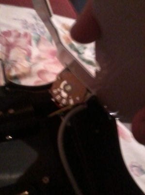

Well I've had the first problem with my Marauder today. The 3 coils active position (second to bridge) cuts out unless you push it a little down (the way it isn't supposed to go) I'm thinking either a bad switch(likely, since its probably a MIC piece of junk) or just a poorly soldered connection.
I'll have to look under the hood later! (Though if it is unfixable it doesn't really bother me, because the triplebucker I use least) what does bother me though is in order to get to the humbucker setting, I have to go OVER the triplebucker setting, and it crackles whilst doing so.

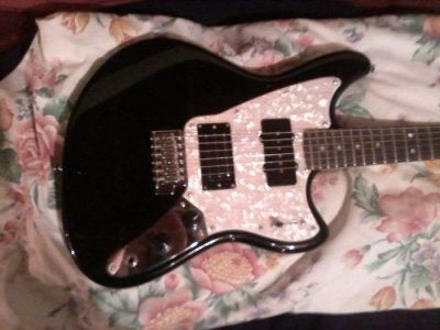

Here they are! (Please excuse poor quality)
From the top (had to put a white pillow on top of the usual black fleece blanket, otherwise the body would be invisible)
Another

Pickguard off (have to take neck off to get it off, because it sits a little under the neck and the p'ups are too big to work around)
Crappy MIC switch. Everything looked fine, but because I'm the careful type, I re-soldered a few connections just to be safe

The finishing was good, they did a fender job of that (not extremely thick like squiers) the finish is VERY thin, thinner than a MIA std. Fender. The wood(koto) is interesting, it has really no scent to it, probably won't 'bounce' like alder or maple, and dents fairly easy. Not a big problem though, I'm careful!
The re-soldering did solve the problem! There must have been a bad connection somewhere.
