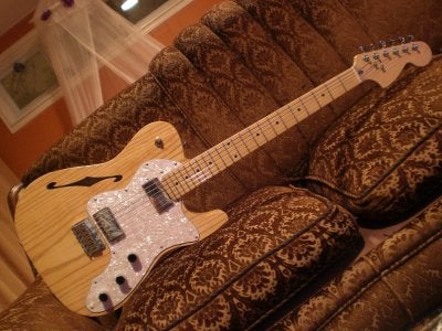

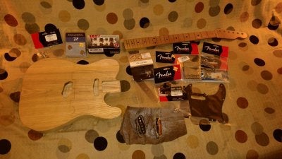

I've only ever owned 1 guitar that I felt didn't need tweaking (& I've gone through a ton of guitars). That guitar is my 61 reissue SG. Everything else has either been a good starting point or not worth the time & done away with. Now I've never forked out the cash for a custom made guitar, but I never would because I enjoy modding anyway.
I did build my own guitar based on the 72 Tele Thinline, then years later modded it too. Lol. Now I never touch it because I'm into other things. The Tele Deluxe hasn't even been finished yet & has been modded multiple times.
BTW, 57 Classics are my favorite Humbucker
