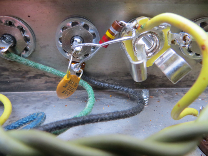

I have here my old 1972 Fender Deluxe Reverb and I got a bit tired of resoldering the RCA plugs every 10 gigs, so I decided to replace the RCA plugs with one stereo 1/4" jack (just like the reissue fenders).
Took out the (reverb-side) RCA female and replaced it with a stereo 1/4" female. Then soldered the reverb to tip and vibrato to sleeve. There is also a capacitor that goes to the ground of the former vibrato RCA plug. Here is a pic, not mine though:
But since it simply goes to ground I left it there at the ground of the "former" vibrato RCA.
Seemed like a perfect fix, but I have two problems:
- there is a loud click sound when I push the vibrato knob. It's not always there, sometimes I push it five times and I have no click at all, then I click it another five times and it's there... unpredictable, but it wasn't there before.
- when I turn up the reverb there is quiet some hum that was not there before the "fix"...
Anyone any idea? Can I actually just replace the RCA jacks with a 1/4" jack? Or did I overlook something? Why is there a cap at the ground of the vibrato RCA? Because I can't find it in the blackface models...

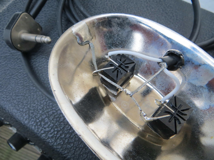

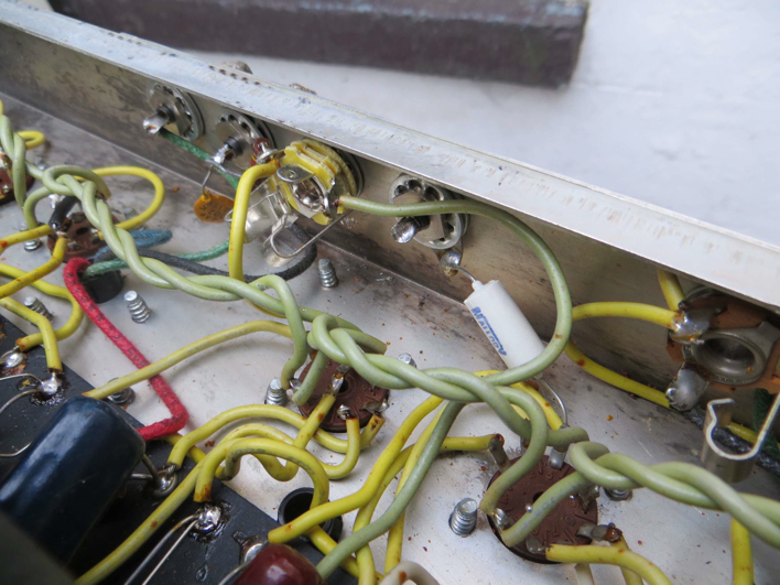

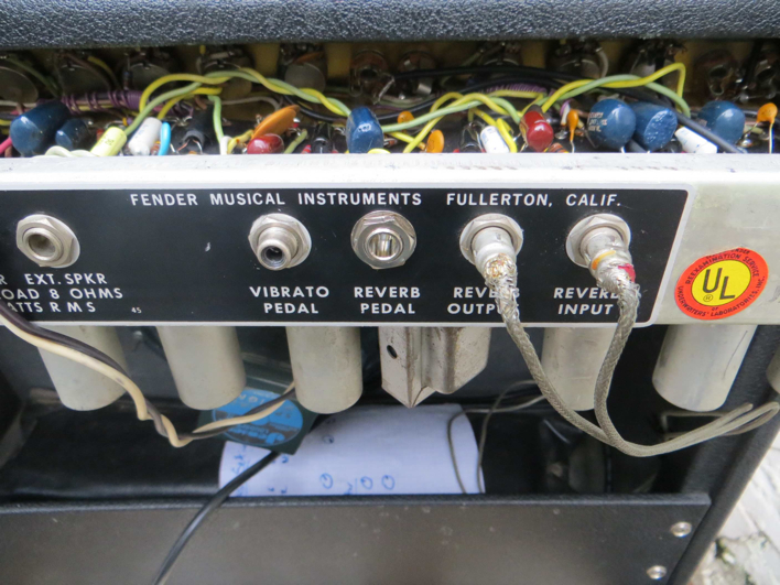

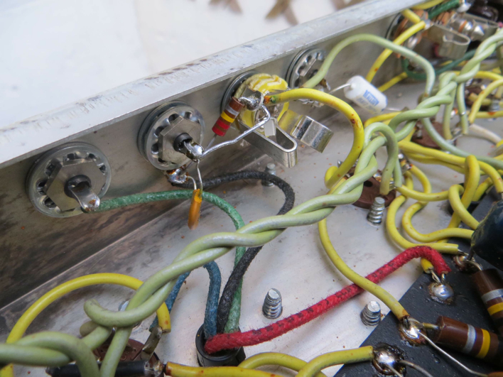

By the way, here are some pictures I took this afternoon of my Deluxe Reverb and the 1/4" mod I did. Maybe this helps locating the problem? I already pushed the green and yellow wires to the amp's chassis, away from the heaters, just to be sure. Doesn't make much differece though and doesn't affect the "click" problem...

Guess I was unclear when i wrote that I thought the "click" from the vibrato switch entered the tube for the reverb return.That is because the leads are so close now.
The fact that you write that it gets louder when you turn up the reverb confirms my theory.Fender solved the problem by redesigning the circuit of the reissue.Let me state this first.There is nothing wrong with your amp.There is no problem to locate.The only thing that has happened is that you put the vibrato and reverb lead in the same jack and plug which has led to that noise from the vibrato enters the reverb channel.The simplest solution is to separate them again.If you change the vibrato pedals jack to a 1/4 " mono jack you can connect it to the vibrato lead .You can leave the reverb lead soldered to the tip of the 1/4" jack and solder the sleeve to ground.I assume you had to make the hole bigger for the 1/4 " jack which probably has devalued the amp.Being no expert I don´t know how much but I don´t think one more hole will matter much.If you are determined to just have one jack,you must do what Fender do,change the circuit.

I'm no expert, but that sounds right. When you had two RCA plugs, you had two different hots and two different grounds, and the two separate grounds were probably wired to different places in the amp, with a cap or something somewhere on one of the ground points to prevent popping. When you put in a stereo plug, you still have two separate hots, but the separate grounds ended up being combined together and going to ground into the same place. If you went with two 1/4" mono plugs, then you could restore the original wiring scheme and the pop would go away.

Inductance isn't the issue. The issue was hit upon when figuring out that A) the cap wasn't wired in, because it needs to be in the switching circuit for the vibe. B) the return signals of the reverb and vibe switches can't be on the same wire because they do go different places in the circuit. If your amp is going to remain your amp and function is more important than form then ditch RCA for mono 1/4 jacks(non shorting, isolated)

Yes,if you change the RCA jacks to 1/4" jacks and wire them the same,the click should disappear because it wasn´t there before the original wiring scheme was disturbed.
