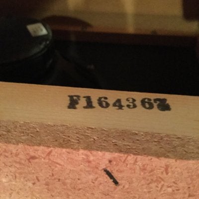

    Is the serial number on a small metal tag? There may be a stamped date somewhere in the interior (pictures are from my drip-edge bassman cabinets).
    AlbertaGriff, Huddy and Wally like this.

    Also, for the date, look for an ink stamped manufacturer no. inside like @randym's pic shows. Many people dont realize Fender stamped those even in combos cabs, although, like all things Fender, they weren't consistent about it!
