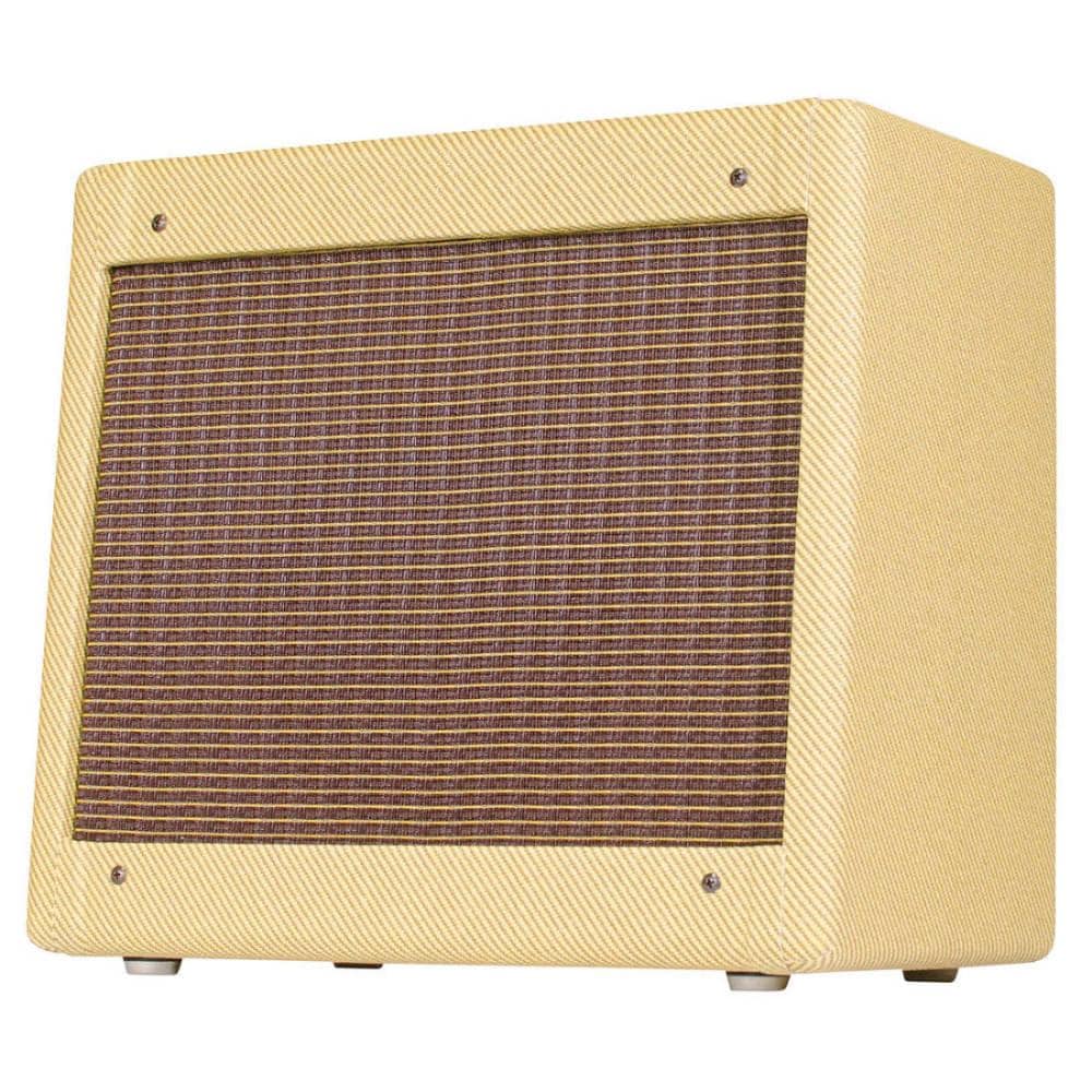

Happy weekend to you all. I’ve been thinking about buying a 5 watt amp, most likely a Fender 57 custom champ, and wanted to ask those who own one a bit more about them. Most of the reviews out there are positive, as reviews tend to be, and listening to the tones Julian Lage gets out of his is certainly a factor (yeah yeah I know it's all in his fingers). This will be my first tube amp. I'll be playing at home and don't see myself gigging with it, so I'm looking for something small, but with "nice" clean tones at volumes that don't get me evicted from my apartment or divorced by my wife. I play mostly ambient and jazzy stuff these days. Some youtube clips I listen to sound very thin, tinny and trebly, but when I listen to others they sound pretty full with decent mids and bottom end. It's hard to tell what's real and what's not on Youtube, hence my question here.
Then... I saw Stew Mac sells a kit. This is appealing as it's half the price, and building things myself is something I like to do. So.. does anyone have experience of both, and if so is there a noticeable difference from having different components, speaker, etc? (I would pay up for the Fender amp if it sounds better, but part of me is hoping the answer to this last question is "no, they sound alike").
Anyway, looking forward to hearing thoughts on the above and what people think of these small amps in general.

Building amps is a fun and rewarding hobby. Build head units rather than combos though, they take up less space, which equals more builds. Win!
Champs and their ilk are good amps to start with. ( opinion ) Everyone needs a simple, one knob amp to noodle with. You are in total control via your picking, picking position, guitar volume control, guitar tone control. It's you, and there's no hiding.
Only one minor issue with the original Champ, and that's the chassis size. It's a bit of a tight squeeze in there. The 5F2a is a Champ with a tone control. Bigger chassis = easier build.
Stock 8" speakers are fine when mic'd or used at close quarters, but personally, I prefer 10" for the room sound. I get round this by building head units and having some very good 10" cabs :)
I don't know about Stewmac kits. Here in the UK we have the Ampmaker WF-55 as our BritKit of choice, and it is a superb sounding amp. Do you have any domestic kit companies? I don't know if Barry would ship to Japan, or if the transformer would be suitable ( It's 120/240 ). Crazy good amp when built though. The secret sauce is the transformers.
I see kits for sale on Aliexpress that may be viable for you, there's also a plethora of Champ-a-likes at low cost. These tend to have a 6Z4 rectifier in place of the usual 5** Octal rectifier. They're marketed by sticking a badge to the front by many companies, and seem to be none the worse for it. That 6Z4 isn't the most reliable rectifier out there. There is a Soviet Kenotron equivalent which will give years of trouble free service, but maybe best wait until things clam down before that route is explored. Juketone in the UK is one company that rebadges the SinoChamp to great effect.
As to my opinion of small amps, well, I have too many. To many for current shelf space that is...
I love 'em. I enjoy building them, and I enjoy the sweet, sweet sounds. The sounds are all the sweeter because there's that personal connection of making the electrical arteries connect to bring life, and sound from heat, which is also kinda neat.

Lots of great info in this thread. Thumbs up on the 5F2a just for ease of build if nothing else -- the 5F1 chassis is the size of a toddler shoebox. Also FWIW the more traditional choice on 5F2a clones with their bigger cab is a 10" speaker, which if nothing else is more versatile and less boxy.
Be aware that StewMac just re-sells Mojo kits but with S/M instructions (and long list of many suggested tools and toys they will sell you to 'help.') Though Mojo's instructions and drawings aren't quite perfect, they've tended to be better -- and more often updated -- than StewMac's.
Mojo does sell a decent 5F2a kit, and if you need a cab, theirs have been decent also. But... I'm not sure their kit has instructions, and tho you could mostly use their 5F1 instructions, there are just enough differences between the two that new builders may get confused.
Final thought: DIY vs. buy is about way more than cost *or* sound. On a good day a DIY will sound as good as Fender's version. OTOH, you may be surprised how much it costs to get all the proper tools (even if you don't buy the whole StewMac catalog). Do you have a decent solder station, DMM, etc.?
Advantages of paying Fender to do all the work: 1) you can play the amp the same day you get it 2) risks of hurting yourself or harming the amp via builder error are minuscule 3) if you don't love it, you can sell it on at only a small loss -- most of us find even nicely built DIY amps are hard to sell for anything like we put into them.
Advantages of DIY: Fun to learn, fun to plan, fun to build, fun to feel you did it yourself. Either way, enjoy!
