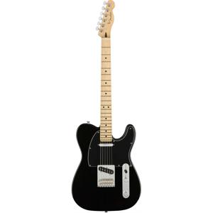

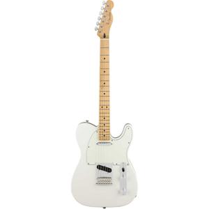

Brand New for $599 from Adorama
Fender Player Black with Maple Fretboard:
or White with Maple:
