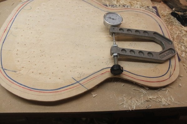

Started carving/gnawing the inside of the back. After I drilled the holes I used a cutzall disc to take out a large portion of the wood. Leaving dimples from the drill bit. If you have never used one of these discs ( I had not) they cut really fast and will remove a lot of wood. If not careful, too much wood. Little bit at a time. Then I used multiple finger planes to clean it up and get it close to the correct thickness. It is very thin, almost scary thin. I treat it with much care now. DA sander cleans it all up. It is sitting on a holder that I made just for this purpose.

Finished cleaning up the f-holes. Made the braces. They are made from quarter sawn spruce. They are different sizes. The bass is bigger than the treble side. Thicker and taller. I spent a lot of time dialing them in to fit correctly on the curve. Then glued them on.
While waiting for the glue to dry I did a final check on the back. It was still thick in a few spots. Carved it down and dialed it in. The pic is of the diy thickness gage I use, I clamp to the bench sideways and measure. The dial indicator is spring loaded.
