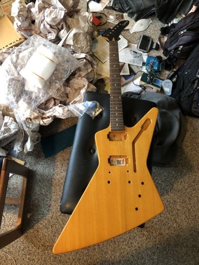

Unboxed it last night :)
Arrived in very good shape.
Early specs:
The guitar and neck only (not even the nut or TRC is on guitar) weigh in at 5lbs 2oz.
That’s pretty damn light even without the hardware.
Thickness. Didn’t feel thick without strings. Tried to simulate that and felt a little more substantial.
Neck Measures at :
1st fret: 22mm+ or approx 14/16th" or .875”
12th fret: 25.5mm or 1”
I thought the first fret would be a little thicker but I guess it’s within ‘58-59 Gibson specs for thickness if it’s not on the high side.
The grain looks pretty darn nice. Much nicer than the first one I saw described above at Manchester Music Mill NH. I mean, much nicer.
That’s the reason I pulled the trigger on this one - was best of any I see for sale online. The grain wrap over the top edge is fantastic. Looks almost tiger striped. Wraps cleanly around.
Obvious long tenon joint. See pic.
Two piece solid wood body easy to verify. Pics at 1am. Will do better soon.

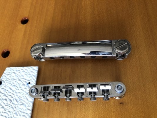

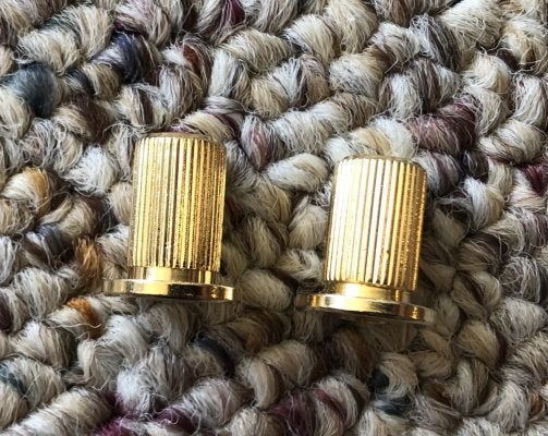

Big question: what the heck is the bridge from this guitar?
I got an Epiphone Locktone chrome bridge and mounts and studs. The bridge is the correct spacing and should be fine. But the bushings for the studs are far too big for the holes in the Explorer. It appears that the holes had bushings in them, and they were about 8mm or ..? The bridge that comes stock is described as 'ABR-1 style bridge' which I am not sure what the 'style' part means.
Are there very narrow bushings that can accept something like a 4 or 6mm stud with thumbwheels?

Still working on this build....
After buying and waiting for 6 in line gold Klusons from Korea for likely a fender, I found that did not fit. Quite confused, thought 116mm spacing would be close enough.
I finally got a set of 6 in line Klusons that are black split posts and should be Gotoh as they are stamped "Japan". To anyone trying to sort this out: it looks like the spacing from center to center the outside tuners (#1 and #6) needs to be 119mm. Not 116mm. The gold Korean 6 on a strip tuners fell short and the bushings would not mount. But these (probably Gotoh SD91 - it was unknown by seller) DO fit :)
They are lightweight and have a very deliberate tight smoothness to them. I like them very much and I haven't even strung them up!
I custom cut a sparkly white pick guard, rear control plate cover and truss rod cover from scratch in a band saw and evened out with hand metal filing.
I had to re-cut down the guard to make it look a little closer to the '58 thing.
Next: Installed Epiphone Locktone chrome stopbar tailpiece. Using I imagine the standard epiphone stud inserts that came with it. Had to really push those bushings with a lot of force.
I bought a set of "Blizzard of '59" pickups from BYO Guitar. Got those in person from very nice owner. These are PAF style zebra pickups and read about 7.38 and 8.15 for neck and bridge. He wrote down the exact reading on them from his meter when I was there. I got these on the strength of many testimonials here, particularly from member Antiqua and his analysis post. I have an original era Seymour Duncan 59 bridge installed in the neck of a mahogany explorer, and a Wolfetone Dr Vintage neck installed in my other 'Korina' (Mahogany) Epiphone Explorer Clapton cut. They both sound amazing on my hybrid tube/SS Vox.
Also got a set of amber bell knobs for the pots from BYO.
Still need to source 500K pots, wiring and toggle switch. Got a Switchcraft jack, and will cut another jack plate for that from the sparkly stuff. Anxious to get this playing!
That bridge sounds like a “modern” ABR–1. It’s the old style, ABR-1, but instead of mounting old-school style directly into the body with wood, screw type mounts, the screws thread into bushings in the body. But the bushings are smaller as you see – more like 8 mm.
They make some “conversion“ bushings in that size. Gibson Nashville Bridge bushings are also that size. Threads may vary.

Hey thanks! So there are very small bushings for some of these then. So my eyes don't deceive me with the vertical channels into the body of my epiphone.

Here's some better pics. I am still struggling to build this guitar.
I got bushing / insert from Gibson that fits perfectly for the bridge, but I only have one.
Still working to figure out how to source a 2nd one.
The grain wrapping around the body here is just beautiful. It really is a thing of beauty looking down at it.

I’ve been meaning to follow up.
Let me just say I Adore this guitar.
I finally (with the help of Gibson) got a second post for the bridge.
I had bought a lightly used Epi LockTone bridge and tailpiece set.
The standard LockTone bridge had the typical wider bridge post holes.
So, what I did is find something close and made spacers / sleeves for the bridge. I had to slightly enlarge the hole with the correct drill bit and hand file down the outside diameter of the aluminum sleeve I found.
I got a nice tight fit. Got a very long 4mm bolt at local hardware store. Sawed off the head and cut it in half and screwed the two posts into the body inserts.
Result? Well at first, I thought I was going to be selling this guitar off. I was bummed. But then I realized the nut I got included with this guitar had never been installed and was far too tall. It made the action super high and the guitar setup a mess. I had lowered the bridge all the way. It was a buzzing mess.
