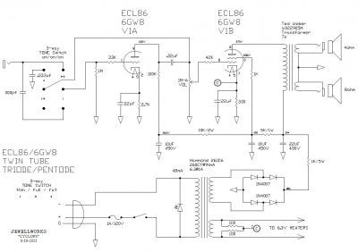

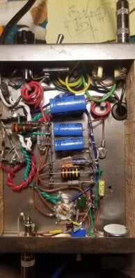

hI @Jewellworks i have no experience with those tubes at all, but I'm curious what your 1 tube amp looks like, would you be willing to share the schematic and/or layout if you have it?
the ECL86 is about 4 watts SE. if you want to use any of the other aforementioned ECLs, they are not interchangeable. the pinouts are different, so check that.
i didnt use the CT on the PT because i messed up and got the wrong PT type. using the CT would have given me over 500VAC! instead i used a full wave bridge rectifier on the PT, then knocked it down a tad to keep it around 270 at the plate. see my load lines for reference.
i used a tone switch, rather a knob. its mostly clean with a nice growl even without a booster pedal in front. i use a Bad Monkey pedal and i think it sounds great. its up to you if you want to use a tone pot, but depending on what you use, it could decrease the drive if you do.
