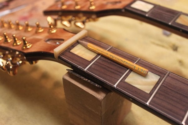

Not only do I make the pencil on the little belt sander, I do the rough shaping of the nut too
Also good for trimming your finger nails. I can always tell when I'm working with bone, it smells like burning hair.
View attachment 1325820View attachment 1325821
this ^^
All kidding aside - the 1/2 pencil tool is amazingly good for roughing in nutslots. I make them the same way with a belt sander and have been using them for decades. When roughing in the nut slots I just file down close to the line without touching the line, and the nut is ready for strings at that point.
