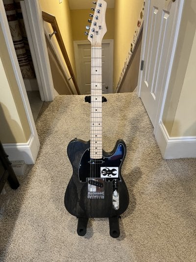

Big_Vig
Jul 23, 2018
78
Wilmington NC
On the pictured partscaster.
1. Sand progressively: 320; 400; fine Scotch Bright scuff pad
2. MinWax Ebony Stain (or your chosen stain) rubbed in, wiped thin.
Dry overnight
3. Equal parts Mix:
Clear Polyurethane
Boiled Linseed Oil
Turpentine, Odorless
Japan Dryer added at about 5% of volume
4. Apply the wet Mix with fine #4000 steel wool.
Let dry about 1/2 hr.
Heavy wipe with paper towels.
Let dry 2 days.
5. Rubbed with #4000 steel wool, wiped hard with microfiber cloth.
6. Apply Mix very light with fine scuff pad.
Let dry 1 day.
7. Apply and rub hard with Bees Wax with fine scuff pad.
Rub hard to wipe with paper towels.
8. Optional: Buff with Bees Wax with microfiber cloth by hand or buffer.
If you want to relic the finish just go at it with a fine scuff pad.
