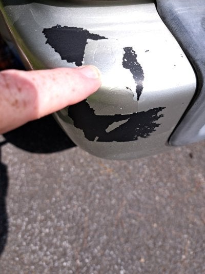

ALSO, some masking tape is very aggressive. I just ran into this today on a bumper. After touching up a small ding (fingertip) I removed my masking tape and up came the poorly applied paint from someone's previous repair because they did not rough up the primer. Live and learn. I used an overly-aggressive blue tape.
