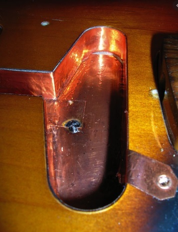

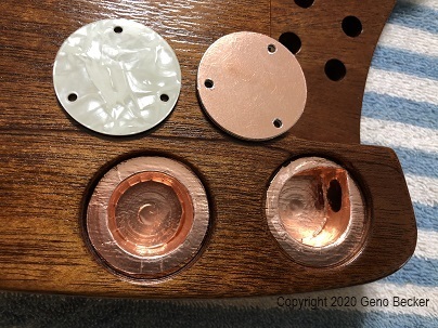

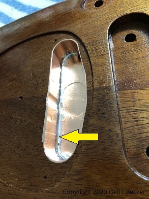

I've tried the carbon paint, but I prefer copper tape. I get my copper tape from Delphi Glass (stained glass supply house).
My greatest concern would be to wear gloves to make sure my fingers don't catch and edge while I'm pressing the tape in.
You're using your fingers? Try this next time: a brand new pencil with a rubber eraser on the end. Wrap a layer or two of shop towel over the eraser and use that to 'scrub' the tape flat into full contact with the surface. It comes out looking like the cavity has been copper electroplated, and your fingers aren't all torn up.
I usually run a bead of solder all the way around the bottom corner of the shield to join everything together.
