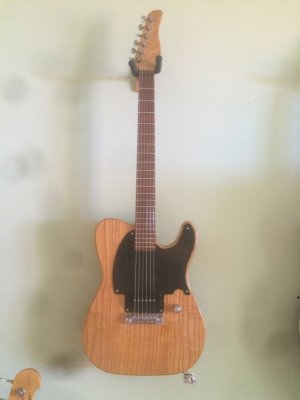

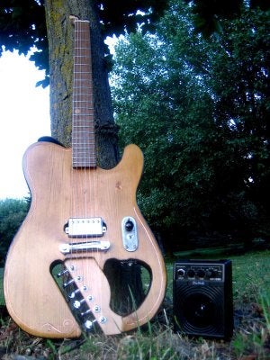

    Quite a few have put a LP bridge on a Tele. You don't need an angled pocket. You will need to consider the fret plane above the body and the bridge location.
    One on the left benefits from a thick neck and the reverse tuners at a drop angle instead of the drop tail piece. The one on the right has a slightly recessed bridge. The amount of work to install a LP bridge is considerably more than a standard Tele bent plate bridge.
    travel guitar I built last year Another I built later last year

    jvin248 - first of all, awesome guitars!! I love the "backwards" Tele!!
    Could you explain what you mean by the fret plan above the body? How deep did you have to recess the bridge?
    Thanks!
    The plan on this build was to use a 12" radius.... thanks for the tips!
