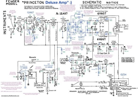

As I started to study the circuit, I realised that the “vibrato” channel of the Deluxe Reverb is not very different from a Princeton Reverb. After all, the amps were contemporaries in Fender’s “blackface” era, and based on the same circuit design principles. The main differences are:
  • The Deluxe has a Long Tail Pair phase-inverter. The Princeton uses a cathodyne phase inverter. This changes the way the amp breaks up as you crank the volume, and is one of the biggest reasons the tone is different.
  • The Princeton uses a “bias wiggle” tremolo design, whereas the Deluxe has a very different design based on an opto-coupler. Many people prefer the Princeton design, and I decided I would try to keep it.
  • The Deluxe’s vVibrato channel has a small “bright cap” on the volume control to increase high frequencies at low volume. I have always been a bit dubious about bright caps, so I initially decided to leave it out, but later added it as an option with a push-pull volume knob.
  • The amount of negative feedback, which is used to clean up the amp, is different. And it is inserted at a different point in the circuit, which has to do with the LTP phase inverter having gain.
  • The Deluxe has a 12” speaker, and the Princeton uses a 10”. It is possible to fit a 12” speaker in a Princeton cabinet (it’s a fairly common Princeton modification), but I tend to use the amp through a cabinet emulator anyway for silent playing, so this was a little academic. I decided to leave my Jensen C10R alone.
One way to think of it, is that the Vibrato channel of a Deluxe Reverb is akin to a Princeton Reverb with a different tremolo, a Long Tailed Pair (LTP) phase inverter, and a bright cap. Or conversely, that a Princeton Reverb is like a single channel Deluxe Reverb with a bias wiggle tremolo and cathodyne phase inverter.
There are a few other minor circuit differences, including some modifications I had made to the Princeton, such as switchable negative feedback and mid cut and boost EQ controls, but it raised a tantalising question: could I modify the Princeton Reverb into a single-channel Deluxe Reverb by changing the circuit, but reusing the cabinet, speaker, chassis, transformers, reverb pan, filter capacitor can, and so on?

I used the drawing software OmniGraffle to add layers to the original Princeton Reverb drawing, hiding certain parts, and drawing new ones (in blue) until the circuit represented my single-channel Deluxe Reverb. You can see my annotations in purple. I have also labelled each resistor and capacitor for ease of identification.

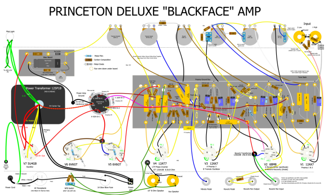

Here is what this layout ended up looking like. I used the DIY Layout Creator software to draw this, starting with Rob Robinette’s Princeton Reverb file and following my schematic. I labelled each component on the schematic and used the same names in the DIYLC file to make it easier to correlate the two, taking plenty of inspiration from the Deluxe Reverb schematic.
You may notice there is no “dog house” with the large B+ filter capacitors you’d see in a Deluxe Reverb. Instead I am reusing the capacitor can that serves the same purpose in the Princeton. There is also no choke. This worked fine and met my goal of reusing as much of the Princeton as possible. Another option might have been to cover the hole for the filter cap can and extend the turret board further to the left to fit full size filter capacitors.
I now had a layout, but it was clear I could not use the same turret board as the Princeton. The preamp stages were pretty similar, but over at the phase inverter end, things had changed quite a lot. I also needed physically more space, as the LTP phase inverter is more involved than the cathodyne one.
For space reasons, I moved the dropping resistors to the filter cap can lugs, and moved various things around to fit everything in and make wire runs as short as possible. It’s worth noting that the position of some of the tube sockets is less optimal for the Deluxe Reverb layout, leading to some slightly longer wire runs, but with some care I was able to avoid any spider webs.
Then I needed to make a circuit board. I decided to stick to turrets, since that’s what I had experience with, but with a new layout, I had to make my own drill template. I ordered fibreglass board and turrets from Modulus, and a cheap “swaging tool” from AliExpress to fix them to the board. I also had to get a drill press - something I’d put off for too long - to be able to drill the turret holes straight and perform the swaging itself. Here’s what the drill template looked like:
This was also drawn in OmniGraffle, using a 1:1 A4 resolution and various hidden guides to get things to line up. The black circles represent areas to install turrets and the white circles represent holes through which I intended to run wires down under the board. I wrote the names of the components that go in each position other help test the layout: before starting the drilling process, I printed the template and physically laid each component on top of it to make sure there was enough space between the turrets.
Next I had to get all the new components: Resistors in various values, capacitors (I went with Orange Drops), that elusive 6BM8 tube, and extra wire. All from Modulus, with tubes from Watford Valves. And a few add-on orders for things I’d forgotten or hadn’t realised I’d need. (The First Rule of Resistors is: No matter how many you have, you are always missing the specific one you need.)

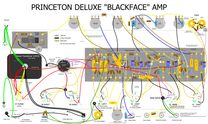

To understand why, we need to consider the most significant difference between the Princeton and Deluxe Reverb circuits: the phase inverter. The cathodyne phase inverter in the Princeton has no gain, but the Long Tailed Pair one in the Deluxe has lots. And so whilst both circuits have a pretty similar third gain stage (which in my schematic uses the V3A 12AX7 triode), in the Deluxe the signal coming out of the third preamp stage is actually significantly attenuated before entering the phase inverter, which then boosts it back up again. (One could speculate that maybe it would have been better to reduce the preamp 3 gain to begin with, rather than amplifying the signal and then throwing most of it away, but I reckon they did things by feel in the 60’s, and this would probably change the tone!)
The first thing I had failed to notice, was that in the Deluxe Reverb, unlike in the Princeton, the third preamp stage has a 220k grid leak resistor to ground. This reduces the gain in the tube itself. I’d missed this when designing the drill template, but luckily it was easy to add it to the layout without adding any more turrets. It’s labelled R48 in my schematic, and “V3A Grid Leak” in the layout.
Next, the Deluxe Reverb has a coupling cap and a 220k “mixing” resistor on the signal coming out of that same preamp stage. I figured since I had only one channel, I didn’t need any mixing, but of course, this was significantly attenuating the volume going into the phase inverter. Since I’d not planned to install this, I technically didn’t have a turret for it, but luckily I was able to fit it to a turret that was originally planned to allow for a short jumper wire to the phase inverter V4A grid connection after the C13 coupling cap. This resistor is labelled R49 in the schematic and “V3A Attenuation” on the layout.
With these two changes, the gain was no longer insane, but there was still too much background hiss. And I didn’t realise it at the time, but this was still due to the amount of signal coming out of V3A / Preamp 3. I only discovered this once I started tracing the circuit in a lot more detail. Rob Robinette’s Deluxe Reverb pages show a copy of a schematic from a Fender service manual that calls for injecting a test signal (a 1Khz sine wave at 37mV amplitude), setting the controls in a certain way (volume on 7 with my knobs), and then measuring the AC voltage at various points of the amp, predominantly the grids (“inputs”) and plates (“outputs”) of each triode.
The green and purple paths here are the relevant ones, and the target values are shown in the yellow ovals.
I used a handheld oscilloscope that has a signal generator built in and a multimeter on AC mode to replicate the readings, tweaking the volume control to match the expected signal coming from V1B. (A multimeter is safer and easier than using an oscilloscope because the plate connections have high DC voltage that could damage the scope if you put the probe the wrong side of the coupling caps.)
The values I measured were very close to the expect ones… until I got to the grid of the phase inverter (V4A in my case). Here, the ask is to measure peak-to-peak AC voltage (most other readings are RMS), which I could do with my oscilloscope (after the coupling cap!), and instead of the expected 5.3V AC peak-to-peak, I read more like 13V. And with all that extra amplification came a lot of extra hiss and noise.
At this point, we should remember the other major difference between the Princeton and Deluxe Reverb amps: the tremolo (aka vibrato). In the Princeton – and my amp – there is a “bias wiggle” tremolo that affects the bias current on the power tubes. The Deluxe Reverb uses an opto-coupler circuit that wavers the volume – you guessed it – between preamp 3 (my V3A) and the phase inverter (my V4A). I had completely ignored the little line going down into tremolo circuit on the basis that I wasn’t trying to replicate it, but just because I wasn’t going to use it, didn’t mean it wasn’t relevant.
The signal just before the 220k “mixing” resistor (my R49) splits off down to the tremolo and into the first lug of a 50K potentiometer, where the opposite lug is wired to ground. That is as if we’d inserted a 50k resistor to ground at this point of the circuit: a lot of signal is being siphoned away, leaving less in the circuit going into the mixing resistor. I needed to emulate that to get an equivalent tone and gain level.
At this point, rather a lot of experimentation ensued. The most basic solution would be to just insert a resistor to ground before R49 of ca 50k. 47k is pretty close, and indeed that is what my “standard” schematic and layout above show (R50 in the schematic and “Simulated tremolo load’ on the layout). It certainly gets us closer. In measurements of the voltage, I could get even closer using a 33k resistor, but I left the schematic and layout at 47k, given logically this is what is closest to the 50k tremolo pot in the Deluxe Reverb. (The audible differences are small anyway.)
However, in the course of these experiments I decided that I actually liked the option of having more gain. Derek also suggested it would be possible to turn the attenuation being done to the V3A output signal into a “master volume” of sorts. I say, “of sorts” because whilst turning things down here certainly makes things quieter, it also makes the amp cleaner. This is because much of the overdrive comes from the phase inverter and power tubes, so driving them less hard makes for less overdrive. Which can be either good or bad depending on what you want.
The easiest way to wire it for me was to repurpose the “external speaker” second jack on the back of the amp. I’d never use that anyway, and I certainly didn’t want to drill new holes on the front panel or run long wires from this part of the circuit to the front. This also necessitated making room for the coupling capacitor that the Deluxe Reverb has on the output of the plate of preamp 3 (V3A for me), which meant I’d be short a turret. And installing a new turret at this point would mean a lot of reworking of wires and components. The most pragmatic solution was to put the volume control after the R49 “mixing” resistor, because I could then use the lugs of the volume pot to secure R49 and C13.
This layout shows the more logical way to do it: run a wire from the turret where R49 (220k) ends to the volume pot and then – because of physical proximity – put the C13 (.001uF) coupling cap between the volume pot and the tube socket. Except in my case, I don't actually have that second turret, so I ran the 220k resistor directly from the start turret to the volume pot, without the wire. It was just long enough. Ugly but pragmatic.
This design worked well but it presented a different practical problem. A knob on the back on the amp works best as a “set and forget” thing (since you can’t see what it’s set to). And I really wanted to have a “DR default” as the standard setting, but then also options for “more gain” (turn the pot up) and “cleaner” (turn it down). I could measure the exact position that gave the required gain factor (5.3V AC peak to peak on V4A grid at 7.5 on the knob....), but marking this on the back of the chassis as the “default” position was not very useful if I couldn’t see it. At this point, I started researching detent pots and indexing knobs that would “click” into a default position at about 75% turn, but no very good options presented. (A good friend of mine is going to 3D print me one though and I can't wait to try it!)
So I decided on a different solution: a three-way rotary switch with options for “cleaner”, “normal” and “more gain” using fixed resistors. Again, it was most practical to wire these after the 220k “mixing” resistor (R49). And again I used measurements and experimentation to arrive at the values for resistors to ground: 68k gave the a gain very close to the stock Deluxe Reverb amount. I chose 33k for “cleaner” (remember: lower resistance means more signal is going to ground and so less signal is going into the phase inverter), and 220k for the “more gain” option. Here’s what that looks like in schematic and layout form:
You’ll notice R50 is gone and replaced with the (comically large… it doesn’t seem to want to to be resized in DIY Layout Creator) three-way rotary switch that has three different resistors to ground. And again, I’m using the switch lug as a way soldering point for the mixing resistor (which in the real world runs directly to the switch without the extra wire and turret that I don’t have) and second coupling capacitor.

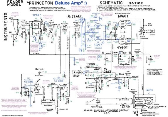

For anyone following along at home... Attached to this message you'll find the schematics (with and without the "more gain" switch), and DIYLC layout drawings (I can't seem to upload the .diylc files themselves on this forum, but I'm happy to share!), and the drill template.

At the time, for the heck of it, I had gutted my Fender Hot Rod Deville to use it for a few experimental circuits. I wanted to replace the solid state reverb with an all tube reverb. After many revisions, I ended up developing two reverb circuits, one of which I used on the Hot Rod Deville and one that got put on the shelf that I never ended up using until the OP and I began talking.
Each circuit was designed to use a single preamp tube. The circuit used in my Hot Rod Deville uses a standard Fender style tank and reverb transformer, 25k to 8 ohm. But the one I used on my Hot Rod Deville uses a single 12AT7 as the driver and the recovery. I had asked Paul Fawcett about using a 12DW7, which has a 12AU7 and 12AX7 in the same bottle, but Paul advised against it, showing me that a reverb driver needs high gain as much as it needs high current.
The result was okay. The reverb was stronger than what you'd find on a typical Marshall with their "hint of reverb" circuits. But it was not anything near the very thick and rich reverb you'd typically get from a Fender reverb.
The other circuit I thought about would use a pentode/triode tube. It may seem odd to think about this now, but quite possibly the most small tubes ever designed were pentode/triode tubes. They were used in a ton of radio and television circuits. All I had to do is find just one of those tube types where the pentode was power tube and the triode was high gain. That way, a 1 tube reverb circuit could be made using a method similar to what Fender used in the 6G15 circuit.
After spending a day going through my RC30 manual, I finally found the perfect tube for this, the 6BM8, which luckily was used in some other amp design (an Ampeg maybe?) which gives it enough demand to be one of the few pentode/triode tubes that are still being made today. The pentode side is quite perfect for this, it has a max Class A performance of 4-7 watts and the reverb transformer is limited to about 3.5 watts, so the pentode side can drive the circuit cleanly and easily. The recovery triode is very much like a 12AX7, it has a gain of 100, but I should note that it does NOT bias the same way as a 12AX7. While you can center bias a 12AX7 using a 1k5 cathode resistor, you need a higher resistor value for center bias on the triode side of a 6BM8. A 4k7 resistor will give you center bias.
For the pentode driver side, the OP and I found that 2k7 had the correct dissipation, which surprise surprise is the same value used in the double 12at7 circuit if memory serves.
From what I've heard from sound demos the OP has provided me, this circuit performs just as well as the stock blackface circuit. And because this requires just a single tube, instead of the usual 3 triodes, it frees up a triode to replace the cathodyne phase inverter for a LTP PI. This way, we can get a single channel Deluxe Reverb style performance out of a Princeton Reverb amp.
The downside is that a 6BM8 uses 780mA of heater current rather than the 300mA a 12AT7 uses, so it pushes heater draw a bit high. This typically isn't a concern as most amps are to some degree over engineered, but it will depend on what iron you use. If anyone decides to copy this circuit, it may be better to play things safe and use a DR power transformer instead of a PR transformer if you'd have no issues mounting it in a PR chassis. The OP originally was using JJ 6V6s tubes, which are 14 watts instead of the 12 watts of true 6V6s. The JJ's use 500mA of heater current per bottle while true 6V6s use 450mA. This means for a traditional PR circuit, the heater current draw is 2.1A. With a traditional PR and JJ 6V6s heater current is 2.2A. With traditional 6v6's and the 6BM8 heater current bumps up to 2.58A. Whatever transformer you opt to use, bare this in mind. A good match to heater current should run around 0.5A more than you're expected current draw, so a transformer with 3A of heater current would work for this project.
