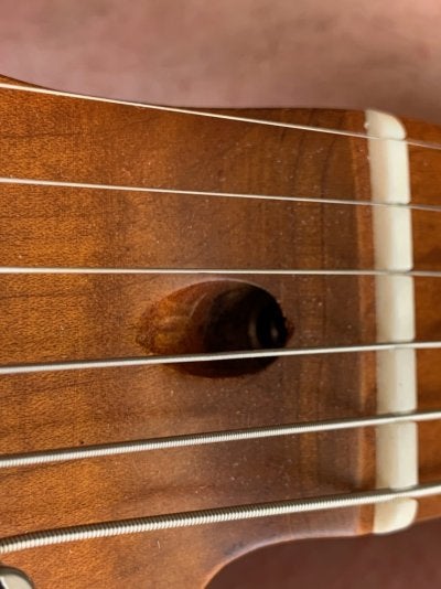

My partscaster build features a cheap, no-name neck from a well-known online auction site. I've a few buzzing issues, so trying to get the neck straight before identifying which frets are the cause. Here lies the problem.

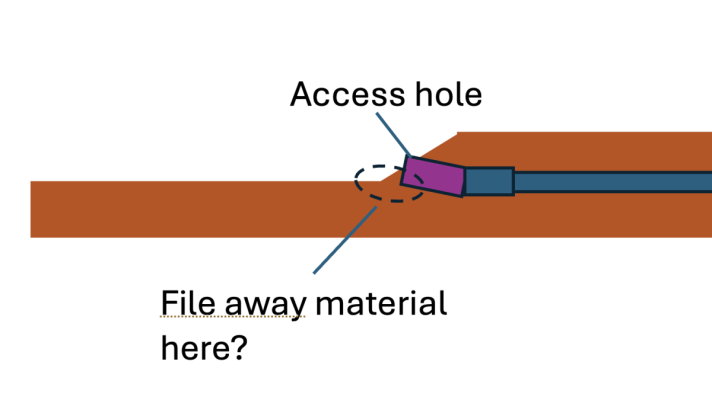

Access to the nut is annoyingly difficult. I assume the nut is 4mm (a 3.5mm allen is too loose, 4.5mm doesn't go in). All the 4mm allen keys I have won't quite engage. I've attached a diagram of the issue and what I think is a solution.

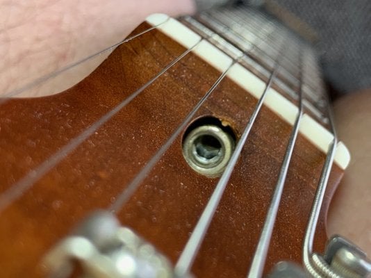

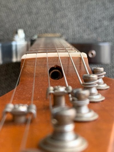

The short side of an allen key won't engage as it clashes with the bottom of the access hole. The long side of an allen key (with the 'ball end') I'm struggling to get to engage - perhaps I've damaged the nut in all my attempts... Photos attached.
My idea was to use a dremel to file away the bottom 'lip' of the access channel to allow a closer-to-90deg approach to the nut.
Or get a allen key set with a very short short side...
Anyone see any issues with filing away some material?

Sounds like you are worried about the nut being messed up. Once you get a straight shot with an allen key, the least risky way to proceed is to find a normal (not "ball end") wrench that fits tightly. If the metal in the nut is indeed scarred up, one approach is to grind just the last millimeter of the key to a slight bevel and see if you can force that into the nut. Lube the wrench and don't try to turn the nut unless the wrench is all the way in the nut.
If the nut gets the hex stripped, you have to learn about a barbaric tool called a "screw extracter".

It’s the angle - the material won’t let any of the ‘standard’ long side:short side ratio allen keys engage as the lip is in the way. The ball-end keys (typically the longer side) also have that problem but I thought their working angle was up to 20deg. So maybe that’s where the damage may be the issue.
I’ll see if I can get a short allen key set (where the long:short ratio is way higher than usual) or see if I can take a dremel to a cheap IKEA key to cut it down.

Be very careful with ball end wrenches. Make sure you have the driving end firmly seated in the broach of the trussrod nut, the broach isn't very deep, the part of the ball that is actually hex shaped is a way up from the end of the wrench, and it's easy to deform the nut by misusing tools.
Trying hard to explain this without saying broach seventeen times. Broach, broach, broach...
The other problem is that it's easy to twist the ball off, potentially wedging it in the nut. It's unlikely, it doesn't usually take a lot of torque to turn a trussrod nut.
I know that Stew Mac sells the things, and I wish they talked about where and when they are suitable. I think that many times what Stew Mac says is taken as Gospel by folks who don't know a lot about tools and practices. Ball ends are fine when used properly, they shouldn't be the first tool you reach for. Many times an Allen wrench that's long enough to extend beyond the end of the headstock is a better solution if it allows a straight shot at the nut.

Do what your pic suggests.... work that bottom edge down some with a round file of something similar....
many necks have more of a hollow down on the neck face...
Drill baby drill! Or file... If you can't get a straight shot onto that head, it is doomed to early failure. The LAST thing you want is a split/stripped/ruined nut.
The result may look like crap, but use that knowledge in your next decision to purchase a cheap neck.
I hear you…. I think the filing option is likely best. I tried a ‘shorter’ allen key, but that didn’t help - it clashed with the upper wooden lip before engaging the nut. A key ‘inbetween’ sizes wouldn’t make it round the corner, so to speak, to be square on the nut. I think a small bit of filing will be simpler.

Well that was simple. I used a small Dremel sanding band, that was just smaller than the access hole, and did a couple of passes at slow speed. That was enough to sort the problem.
I then tried to tidy it up and the band slipped causing that minor blemish to the bottom right of the hole...
I then used the sanding band without the dremel to tidy it up a little better. Apart from the blemish, it would have been a roaring success.
If I want to be a perfectionist I'll need to get a single drop of amber stain! But it's good enough for my needs as is.
