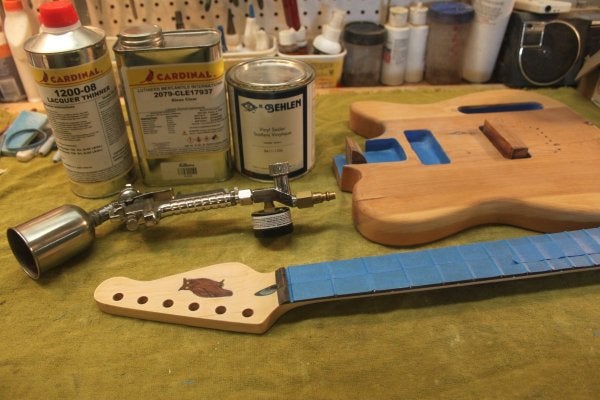

Nitrocellulose lacquer is one of the easier finishes to apply to a guitar. Maple will not need pore filling so you can start with a viny sealer or not. I shoot three coats of lacquer per day, sand to 320 between each group of three. Use a foam pad to back up the sand paper to avoid sanding thru edges. I'll shoot somewhere between 9 and 15 coats depending on the wood and how its building. The final coats get wet sanded starting at 1000 and going to 2000, then two grades of automobile polishing compound (without wax or silicon).
If I was going to put a decal on I would do it early in the process once I was satisfied with the level, then I would bury it in 6 or more coats.
Because of the way lacquer melts in to previous coats you can use rattle cans with good results, if you get a drip or run just sand it off and shoot some more. I have both a buffing wheel and foam pads in a drill motor - the pads work fine for this kind of work.
I've got lots of pictures of finishing things with lacquer - its all I use and I get very good results. I'm far from being a pro.

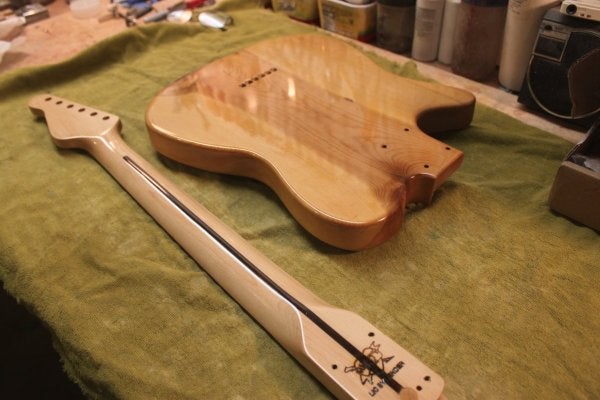

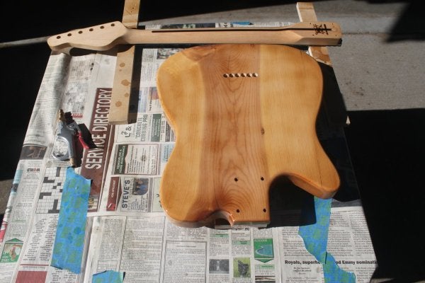

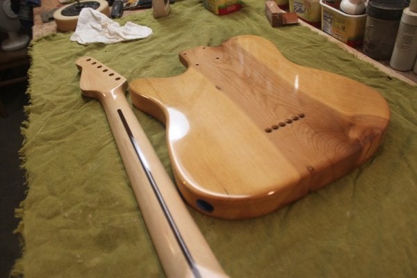

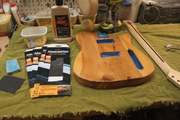

I believe I pointed you to a thread that I did on refretting a maple neck where I showed how I finished over the frets. I also said that its a big hassle and I probably wouldn't do it again.
Here is a maple Mighty Might neck that had a seal coat applied, I sanded that off and shot nitro as I always do. The guitar is kind of funky - the body is hundred year old barn wood, I did a little inlay in the head.
The other thing that I want to say loud and clear is that you should do all your experimenting and learning on scraps of the same kind of wood as your neck or body. Lacquer on maple is about as simple as it gets (as long as you aren't doing any staining) but you still should get it down before you commit to the real thing. If you are using rattle cans get the little nozzles that StewMac sells, warm the cans in water before you shoot. Wear a respirator, shoot outside or with good ventilation - you know the drill.
