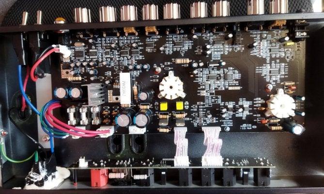

A general overview.

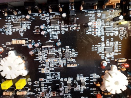

So far, I've confirmed the transformers, switches and fuses are working. The switch only switches live. Nasty. One that switches live and neutral would only cost a penny or two more. All the fuses are intact. A basic wazz round the non-surface mount transistors/regs shows they're all good to go.
I plugged the transformers back onto the board, used an 8 Ohm power resistor rather than plug the OT back to the output board, and powered up.
We have heaters!
We have HT!
We have a stupid standby switch! - It does what it is supposed to do, insofar as it switches correctly. HT is applied where HT should be at the valves.
If I apply a signal to it while I have an 8 Ohm load resistor attached, the 'Infinium' lights comes on.
If I switch off, back on again, it's repeatable.
Switching out the 12BH7 for another one makes no difference. Swapping in an ECC99 makes no difference. I knew the valve was OK anyway.
I sat back to allow my eyes to recover.
I tried putting the signal into effects return. The 'Infinium' light comes on. There is a brief moment where there is an output. There's still HT.
I'd expect a voltage to show at the bias test points. It looks like the 'Infinium' circuit has issues, and that's where I stop. The IC controlling it is not user replaceable.
Why fit such a system to an amp that really doesn't need it. It'd have been simpler, more reliable and cheaper to cathode bias it and be done. I've done a lot more squitting about with it, and it keeps pointing back to the 'Infinium' being the culprit.
