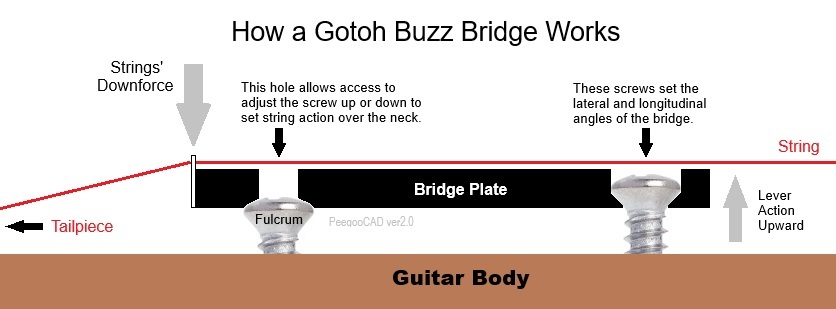

There are 2 screws that look like hex intonation screws : I don'tunderstand how it would work , but it looks like intonation screws ....
Those two little screws in the back simply hold the steel back plate (the 'saddle', actually) onto the polymer plate.
How it works: the single center screw near the back of the bridge is what sets the string action over the neck and supports the entire bridge under the string's tension. The bridge rests on top of this screw's head.
The two screws at the front of the bridge run down through the bridge and do two things; (1) they adjust the angle of the bridge laterally across the body (bass strings higher and treble strings lower) and (2) they are what sets the 'ramp' angle that allows the strings to buzz against the six little channels in the front ofthe bridge. The front of the bridge is under these screws' heads.
Simply put, the bridge is basically a lever that pivots on that single rear fulcrum screw, with the strings imparting a downforce on the back end of the bridge and the two front screws keeping the front of the bridge from lifting up.
It's all quite fiddly at first, but once you understand what the screws do it's easy to set up.

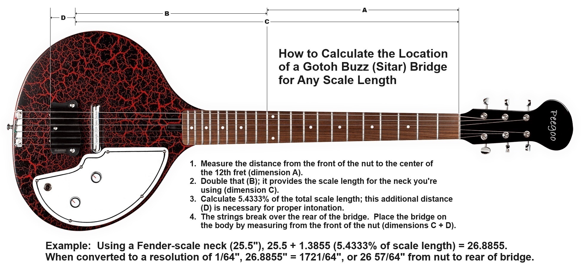

you can probably find the exact measurements of the Gotoh bridge online .
Several months ago I looked online and could find no engineering drawings associated to the Gotoh bridge, so I visited a few music shops that stocked these and took some measurements. Here are the details.
Click on the pic to embiggen it.

I suspected it was plastic .
The traditionnal Danelectro rosewood bridge also works like that , the rear screw acts as fulcrum .
It's actually the reverse because the string balls are anchored to the rear of the bridge plate.
The bridge plate pivots on the two front screws, and the single rear screw keeps the rear of the bridge from lifting.
These original bridges were prone to collapse over time; they 'cave in' in the middle because the cast alloy plate doesn't hold up to string pressure. There was a company that used to offer replacement plates laser cut from stainless steel, and these are bulletproof. I think they're no longer in business, unfortunately.
