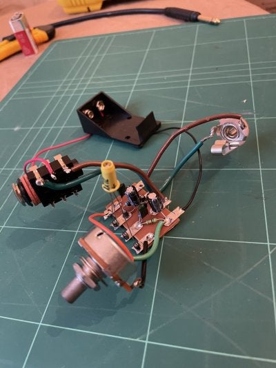

hadn’t actually ever tried an effect unit that runs germanium transistors before.
i had to do something about this.
not really into fuzz pedals, so i thought a treble booster could be cool.
so i had a go at this one.
ordered a couple NOS transistors online, this store claiming that apparently XA112 is equivalent to the OC44 in the original design.
parts arrived.

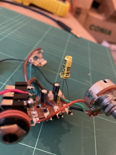

x1 tested at 93 hfe, the other, 218hfe.
following this layout:
built it today, tested it, played it, and wow, i understand so many things now….
initially tried it through a 2203/jcm800 clone thing. nope.
then i plugged it into a ‘BWM Chimp’, (basically a 5w fender champ, w/ pre, tone, and master controls)
- speaker out into a fryette powerstation, then into a 4x12 mesa cab
result:
- holy mother of god.
- i get it now.
- this is the tone.
i never really enjoyed the tone of the ‘wooly’ champ-style amp that i’ve got. even with all the overdrive pedals i’ve tried through it, it never really sang.
but the rangemaster just hits it right.
- beautiful rich harmonic overdrive on a hot bridge pickup (humbucker).
- both neck and bridge clean up really well with the volume controls like never before - allows real precise control over the breakup.
- big 60s and 70s tones. love it.
just need to put it in an enclosure now

I've never tried this. Thanks for the info. Looking at the circuit schematic, it looks like my less than spectacular Ge transistors (gain of about 35) ought to work almost the same since 10K/3.9K is only about 2.5.

Cool, love the tag strip build!
Definitely my all time favorite boost/od of all time, I've built some with switchable/variable input cap to get a wider range of tone. That way I can use them with any guitar with any amp 🙂
I have been meaning to build Joe Gore's Fiendmaster schematic in an amp top version with tag strips like you've done, and try some different Ge transistors I've collected over the past 6 or 7 years . It will go with the Tweed Deluxe I've been building for two years lol. Pedals are a lot quicker to build than amps!

One thing to note is that your meter doesn’t take into account leakage. So your transistors may actually be much lower gain than what you see. Obviously if your pedal sounds good then it sounds good. Just FYI.
This circuit and Fuzz Face (with guitar volume rolled off) were real aha moments for me too.
give it a go, at least if it’s socketed you can always try other pnp Ge’s

cheers, i love working with tagstrips. real solid.
was considering using a chargepump pcb board with a TC1044SCPA, but decided i wanted to run it original with a 9V battery and keep the circuit simple/less noise sources.
i might do a similar thing soon with this one, with an on-off-on dpdt switch on the input (with 4.7nf and 10nf on each side to switch them in parallel with a 4.7nf in centre)
thanks for the advice! i was not aware. perhaps i might like that ‘218hfe’ transistor even more…
Just don’t run it after a modern buffered pedal. I wondered why the RM I built sounded like crap until I ran it by itself into my AC30. WHOA!!!

update:
it’s been fitted.
had this real nice old tobacco tin that i originally picked up for a 12V/9V DC regulated power supply that i built, but it never ended up working (despite reading a healthy 9V DC on the meter, just didn’t work) and i pushed it aside to troubleshoot later…
so with a working rangemaster, i gave the tin a purpose.
This (which most already might know about) is a handy circuit for measuring gain independent of leakage. About half way down the page:
Also, I realized my previous statement about the 2.5 ratio was for DC bias only. That was wrong, because of the 47uF in parallel with the 3.9K. Hence the treble boost. D'oh.
