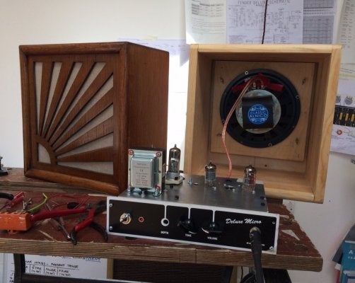

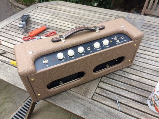

I was turned on to Signomatic via this board. They do a couple of options: digitally printed aluminium sheets (my reverb) or engraved plastic (the micro). I simply design the panel using a graphic design package and send them the PDF.
There are more authentic options (ie proper screenprinted), and plastic (the cheaper option) is limited in size. The metal option will print at, say, 450mm wide, so Princeton Reverb size. It is not as crisp as screenprinting as there's a UV laminate over the printed section but the price is pretty good, around €30, with a turnaround of maybe 10 days.
