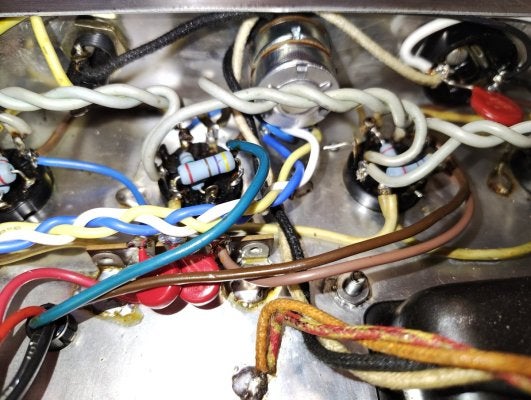

GotA24Fretter
Jan 3, 2024
879
38
TX
The LarMar isn't a bad option. I'm in the middle of putting one in a 1970, so a bit of a different animal--but I'll add a few photos later when I get back in the shop. The bias voltage change is very slight (<1V) from min to max.
