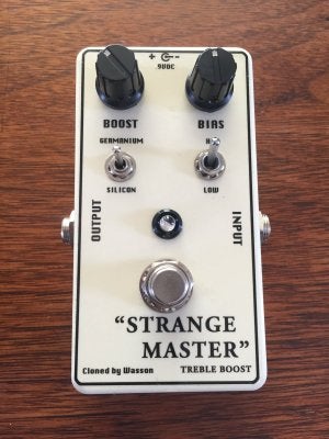

Another FuzzD build on the way, their version of a dual Rangemaster, silicon and germanium:
NOS Motorola BC109 and a Mullard mil-spec CV7112/OC140, the 109 is just over 100 hFE, the germanium is just under. The original schematic calls for a 2N2222A, though even my older can types from the 1980's are well over 150 hFE, I used the last low gain one I had in a Naga Viper build.
Decal is drying again, I've had a heck of a time with this one, ruined 5 decals so far, that never happens especially with a simple clear one like this.
That’s similar to the Strangemaster I built a while back. I liked the Silicon side more than the Germanium side. I only used it with my single coil Strats Though. I socketed the transistors so I really should try different ones in it.
