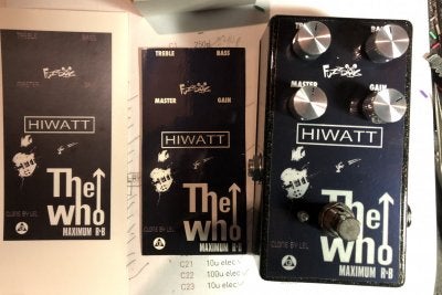

Maximum R&B for sure! Nice foundation overdrive, easy build, decals were a pain. I don't think I'll ever do all black on white decal stock again, look at it the wrong way and it smears, ever after letting it dry overnight.
Decal printed, then cleared, then applied. Held my breath alot when I was laying down decal solvent hoping that the black wouldn't run under the lacquer. Red LED looks cool, almost did white but glad I chose red.

Hey Zippo, can you explain how to paint these and how to put labels on them?
Thanks.
I was using Testor's model lacquer for the bare aluminum boxes, but I found I could get powder coated boxes from a few places that cost about the same as a bare aluminum plus a can of paint so I switched to doing that. The powder coat holds up a lot better than the lacquer, though colors can be limited unless you go with Pedal Parts Plus and they're more expensive.
Decals are just ink jet water slide paper that have been clear coated. The hardest part for me was getting everything lined up. I finally figured out I could scan the drilled box, bring it into a graphics program (I use PowerPoint), then I know things will line up pretty well.
The problem with ink jet (or laser) decals is that you can't print white. The Hiwatt pedal above is a white ink jet paper printed over all black to let the white lettering show. I don't think it will hold up to a lot of stomping though. I don't play out so my pedals don't get banged around too much.

Awesome, thanks. I got some spray lacquer. I also got a glossy clear top coat -- do you suggest that on top of the paint or only after adding the decal?
When creating the decal do you just make it to scale (i.e. measure the enclosure and then make the template that size) in software (I use photoshop)?
zippofan
Mar 16, 2014
1,889
Pennsylvania
I use ink jet decals, they have to be sealed before soaking water, not sure about laser decal paper. I spray a couple coats of Rustoleum clear lacquer to seal the decal, which is printed to scale, before soaking in water and applying. I let it dry at least overnight, then spray clear over just the top. The powder coated boxes don't need the clear on sides and back, and I've had the occasional incompatibility with paint and clear coat to where the sides ran on my painted boxes. It may have been my box prep too, but I had particular problems with purple metalflake and the clear, both lacquers.
There have been a few I had to sand off and start again, it happens.
