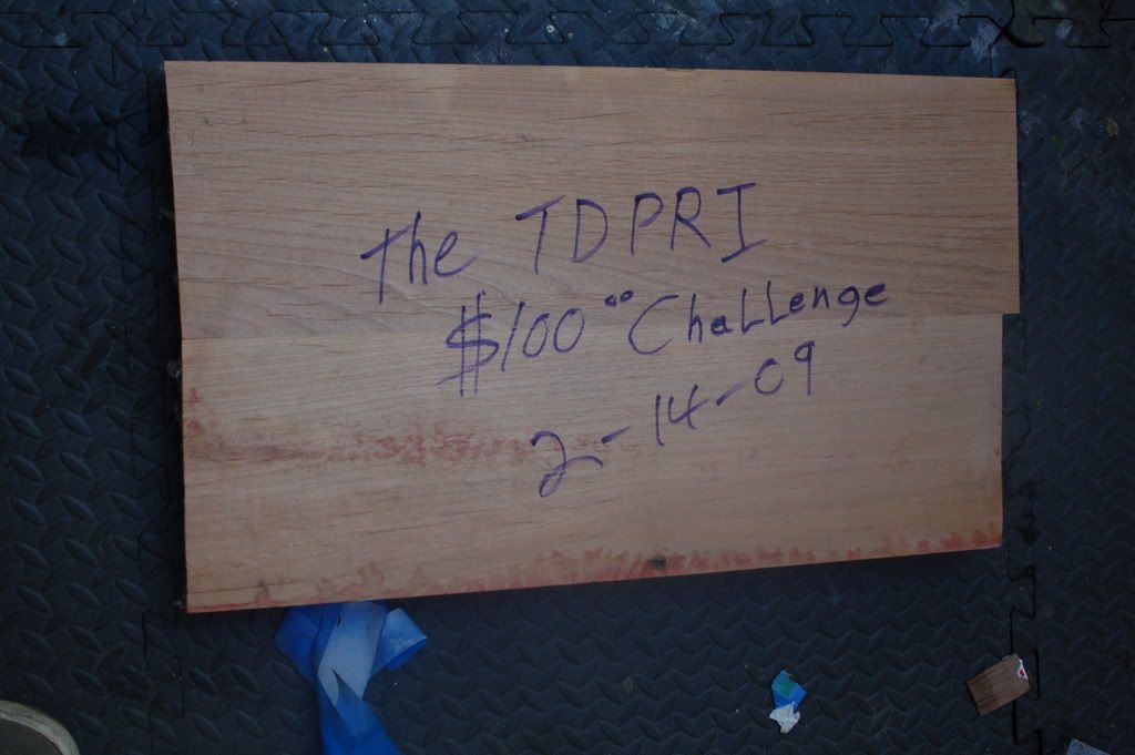

    Ok I am in here we go!
    I have had this for a year . . . Thanks T D P R I Challenge
    for getting me off my but:twisted:
    So overwhelmed I cant even think of a name yet oh well
