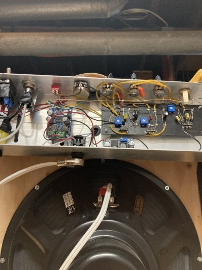

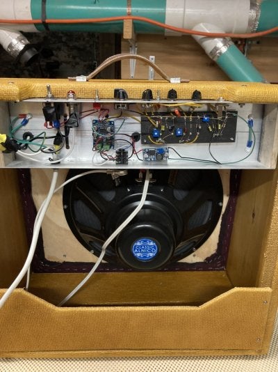

I don't see a ton of interest for SS amps on this forum, but I figured some might find this interesting. I got the idea for this after reading about these cheap little 60W power amps and all the positive reviews of people making pedal amps out of them. I was looking for a simple, light SS amp to put in my 15" cabinet and this seemed like it could work. The basic recipe is preamp of your choice + buffer + TPA3118= guitar amp.
I had been lusting for a JJ-150 pedal and lucked into getting a layout from someone who had cloned it. I first built it as a pedal and loved it so I figured it might actually work for this project. The buffer I chose is basically an Electro Harmonix LPB-1. There is a video of someone using this straight into a TPA amp with good results, and its a simple circuit with free layouts available.
The power supply is just a thrift store 19v laptop power supply with a cheap buck converter to convert it to 9v for the preamp. The chassis is 2 pieces of 2" aluminum angle screwed together. On a whim I added a "dying battery simulator" where the presence knob is thinking I can use this to kill the voltage to the preamp or possibly wire in a different compressor or limiter type circuit in the future. I wanted to wire it all up so it has a vintage tube amp look, so I used an eyelet board instead of pcb or veroboard. I am sure I have less than $100 bucks in this project and that includes and extra TPA amp and buck converter plus a bunch of other extras for future builds. It weighs about 3Lbs.
I put it together half not expecting it to even work, and boy was I wrong! It sounds absolutely amazing! The amp is super quiet and I like the sound as much as my other amps the 5f2-a and the tweed Deluxe. This was a less stressful build and so cheap I figured why not try it! It goes from very brite and clean to super dark and dirty with a huge range in between and it has a very natural sounding breakup. I know some will not believe, but that's OK! The presence knob is wired to a 10k pot which doesn't completely kill the voltage, but takes it way down into super saggy breakup. I love this effect on this preamp and I don't see a reason to change it at this point. I think this platform could be used to build any kind of amp someone would want, by just changing the preamp circuit.

Here it is!

The output of the class D amps is a "bridge-tied load" - there are actually two amps, one feeding the non-inverted signal to the speaker + and one feeding an inverted version to the - terminal. This doubles the output power of the amp. There are a few class D IC's that can be used such that it is not a bridge, but the circuit around the chip must be designed for it.

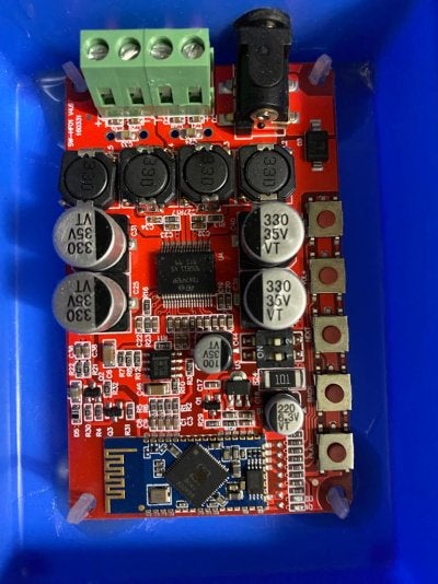

Few years ago I bought a cheap Bluetooth Stereo amp to listen music in workshop when building amps and running in loudspeakers but it did hiss way too much so I did return it. Then I bought a tiny D-class module 2×10W ~$15 which has Bluetooth and use leftover laptop power supply and it does not hiss and sound quite good.
Boxing being said to be problematic for electronics hobbyists and heres my proof. For testing I drilled five holes to small blue storage box for power jack and loudspeaker wires. Then epoxy dabs to corners where four nylon "studs" in corners come, positioned the module and wait for epoxy set. It has function there so I have decided to extend the testing :)PHOTO-2023-07-26-11-58-17.jpg
