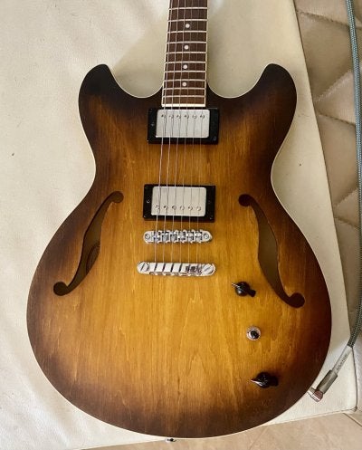

I’m making a new plan. It has been pointed out that pickups won’t change the overall character of the guitar although they do make a difference. I can get nice enough sound from the basic ceramic humbuckers it has. Probably the biggest thing I dislike is they just look cheap.
So my new plan is to mount these chrome trim rings over the existing black ones.
If f the screws are long enough it should work. They fit just below flush with the bobbins.
Well that’s the plan anyway

I ended up with GFS Professional Series, Alnico 2. The neck is wound to 7.6k and the bridge 8.6k with nickel covers. It was really not bad to swap them . I tried pulling just the switch and discovered that was all I needed as the pickup grounds go through the switch as well. After several days of playing I couldn’t be happier. Smoother and warmer than the originals. I am actually amazed at the goodness I’m finding with this “entry level “ guitar.
I also threw on some chicken head knobs.
