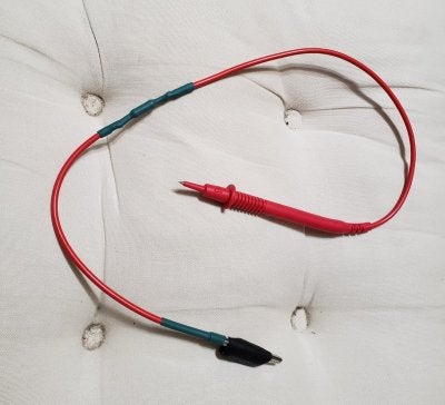

  9. Paul G.
    Paul G. Friend of Leo's
    3,483
    Rhode Island
    Overthinking it.
    Here's what I made.
    I clip it to the chassis so I don't need two hands. Then I touch it to the last node, count to 5, move the the next to the last node, touch and count to 5, etc. until I get to the first cap, touch and hold for 10 seconds. Then I disconnect and check the voltage. Takes 1 minute and saves any worry.

  16. pmacaula
    pmacaula Tele-Meister
    193
    Jun 2, 2019
    Toronto
    For clarity, I have most of the parts for both the basic and 'fancy' versions (see photos).
    Just need to go out to the shed an get a bit of multi-stranded wire (vs the solid 12AWG stuff in the photo).
    Before posting last night, I breadboarded the fancy circuit (+/- rails would be where ground and the capacitor to be drained would connect). Will probably let it sit (unless I need the breadboard for something else) for now & proceed w/ the basic one.
    If anyone does have thoughts on an appropriate value for the current limiting resistor (R2) for the LED, would appreciate the input.
    Cheers. Patrick.
