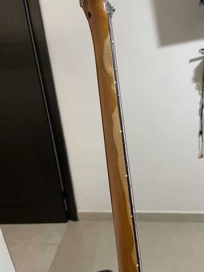

What about weather and nitro? Very dry on summer and very humid during winter. The neck on my American Strat (not nitro), I’ve been playing the hell out of that guitar and last si yet I noticed that the finish was “relicing” on some spots because of the humid room were I was playing.

The "nitro" finishes like hot dry weather - it speeds the complete drying of the film. That American with the poly finish will not relic, except if moisture is getting under the poly around the frets. That can be kinda ugly - this is what happens to my brother's basses, sometimes. But let's say the neck finish on my brother's basses had been "nitro". Well, that finish would be mostly worn off of there, entirely.

I guess my feeling is that a catalyzed finish is going to be more bomb proof in really adverse conditions, but then I kind of baby my guitars. I'm very sensitive to humidity (most of my guitars are acoustics or hollow bodies), I keep them in cases and watch the humidity in my home.
As far as applying the stuff, again, my experience is with lacquer, I only apply when conditions are good (over 60F and under 60% RH). If lacquer is sprayed at too high a humidity it can take on a hazy appearance. Lacquer has been used for many years on all kinds of instruments and seems to withstand a lot of variation
Does Nitro/lacquer gets sticky with humid weather? Like, if I’m “struming” with my picking hand, and my arm is touching the body, does the finish will com off easily on humid weather?
On the attached pic you can see how the neck looks on the guitar I mentioned, last winter I could rub my hand and take of the finish But I never noticed that before, and a lot of that is from playing, only a little area I took off that way when I felt the neck sticky and see what was happening with the finish. I hope I’m explaining myself well, sorry for my English 🙏
