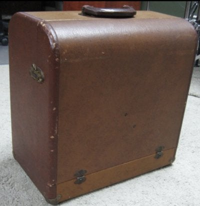

The planning started when I was looking for something to put in an old 12” Ampro speaker cabinet.
4CDF09CD-84FA-4FD6-B9DD-FA37E80EE8B9.jpeg 6F3E6FC4-6C8C-4D0E-8565-785F572DB1AF.jpeg It doesn’t have to much room in the cab and I wanted to have as much clean volume possible out, so I decide to go SE with a 6L6.
Only using tubes that I have at home and at least two of them.
