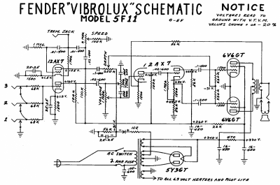

Ive read that these two circuits are very similar and was hoping you fine folks could enlighten me as to how they are different. I'm mainly into clean tones and clean headroom (so I might be barking up the wrong tree here). But Which amp has the better clean tones and stays cleaner as you turn up the volume? I currently own the following. Thanks

Vibrolux 5F11
Princeton 6G2
What jumps out to me is the input network. On a real Vibrolux it looks like the instrument signal is going to be attenuated more than in the Princeton, lowering gains throughout.
But a modern reproduction of a Vibrolux won't necessarily be built this way, and I don't know how much difference it makes. I suppose you could calculate it.
Second, the Vibrolux has a smaller screen-dropping resistor. I associate screen voltages that are closer to plate voltages with higher headroom, so maybe (maybe) the Vibrolux has higher headroom, but all the other voltages matter and how the amp is operating (bias, load line, blah blah) may have a much bigger effect on headroom we couldn't predict just from this schematic and its partial list of idle voltages ±20%.
Third, and contrarily, the better filtering in the 6G2 may let it handle the power demands of lower notes that can make an amp sound less clean when playing on the low strings.
Speaker choice may be more important than any other difference. Higher dB means lower volume settings for the the same volume in the room. The lower the volume on the amp is set, the better the headroom (the less likely a big change in playing dynamics will push the amp to overdrive). Good luck.

Thank goodness some people who have played the Vibrolux and the Princeton chimed in:oops:o_O
I have a question: does a modern builder who does a 5F11-inspired amp wire up the input jacks like the original Fender schematic shows? How does input #1 work?

FYI, Mojotone sells a 5F11 kit. It adds a 1M grid leak resistor to the input cap scheme. It helps with one problem I used to have with the vintage scheme. (It's been a few years, so I hope I remember the particulars right.)
I was playing a Harmony-style guitar. On this guitar, the pickup hot leads ran to the wiper of the volume pot instead of to the "top" of the pot. With that guitar plugged into the #1 input on a 5F11, anytime I rolled the volume control down, the tone would become complete mud. So I had to plug into the #2 input.
Adding the 1M grid leak resistor eliminates that problem. (So does rewiring the guitar so the pickup hots go to the volume pot "tops"!)
I think there was another question about whether the stock scheme would lead to an attenuated signal vs. with the more familiar input scheme of, say, a brown Princeton. In my experience, there is no noticeable attenuation--just that funky response to some guitar wiring.

Regarding the input on the 5F11, the number 1 input is at just under 24kohm of resistance......hotter to the tube than the 6g2 scheme’s 34k. I never ran into any issues with the 5af11’s inputs....work the way I expect an amp to work.
