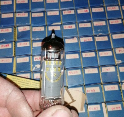

On the subject of Rory Gallagher (he had an AC30 in the early 70s that was modded to use EL83 valves) I bought 4 of these NOS Tesla PL83 'Made in Czechoslovakia' to try out, only £10 inc shipping. The 'P' means 300mA and a datasheet voltage of 15v, they were used in TVs with a series heater chain, I've tried them on 14v wired in parallel in a modded JCA22H and they sound sweet. Also tried with some 50's Mullard PL83 valves too, equally sweet :)
It's been a long time since reading ( could be wrong) but I thought Rory G. ran both the Vox AC-30 AND a '59 Bassman together. Wrong?
He sure could get a great 'Strat bridge pickup only' sound- what an entertainer!
You're right, he moved on to Fender amps in the 70's
Like all great players he could make any guitar/amp sound good and died too young.
