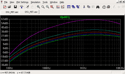

Boss DS-1 is one of the best distorsion for me but need to be mod to be very powerfull.I want to know what do you think of frequency range of clipping D4/D5, just the high pass who is done with C8 / R13.
2.2k + 1uf = 72.4hz who is the standard DS1 frequency.
1k + 1uf = 159.2hz who clip less bass frequency.
With 1k you don't boost 100 hz who is fundamental of guitar that some inge reduce to boost harmonic, like that the sound is not muddy.

Since the cut-off frequencies are measured related to the max gain, a higher cut-off doesn't necessarily means reduced harmonic boost at a specific frequency.
In fact, in this case the gain at 100 Hz in the case of R13=1k is a bit more.
The amount of extra gain you get at min/max DIST setting is between ~ 0.5 - 3.5 dB.

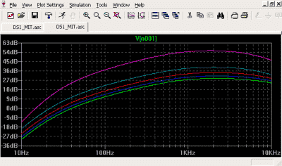

As I said before the cut-off frequencies need to be taken relative to the max gain and they are not 33 Hz and 72.4 Hz.
With 1uF + 4.7k the overall max/min gain at 30 Hz is for example less than in the case of 1uF + 2.2k because R13 controls the maximum gain. The lower the value the more gain at mid band frequencies.
Have a look at the simulations plots below to see what I mean: (left: 1uF + 2.2k, right: 1uF + 4.7k )

I play at max gain, i use ds1 for heavy metal, max gain of DS1 is just what I want not too much. Peavey 5150 for exemple has too much gain I think at max gain.
Thanks for your graph, it explain exactly...all. 2.2k + 1uf at max gain = more high mid (800hz - 5khz ).
The graph is better with 2.2k + 1uf i think.
