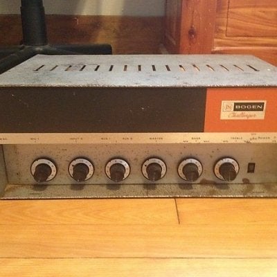

If it was a Bogen tube amp, dirty dirty dirty. Used them for many years as PA. It just seems to be a distortion filled design in general. I think I have had 3 versions over the years. The Challenger was an oft used one.
Some good news though is that Woodward-Schumacher trannies were used in some of them and are readily salvageable. Use the chassis and trannies but dont use the design...

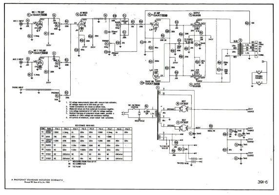

I have a Bogen Challenger CHA-33 on the project back burner. From the schematic, like @schmee indicated, it's bound to sound like a bulldozer. There are many mods for this model. I'll likely revoice one channel for a bit less midrange, give it a presence control, and convert the 'phono input' to a line in to use my Joyo American Sound as a preamp stage.
The blurry schematic is the dual 5Y3GT version, but mine is the single 5U4GB version. They seem to be putting 480 V. on the plates of the 6L6GBs, which seems like it's about 100 V. higher than their rating, so I may be addressing that issue.

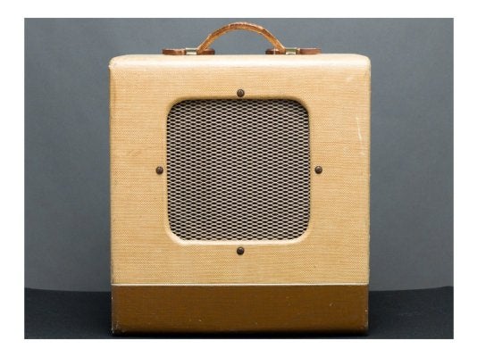

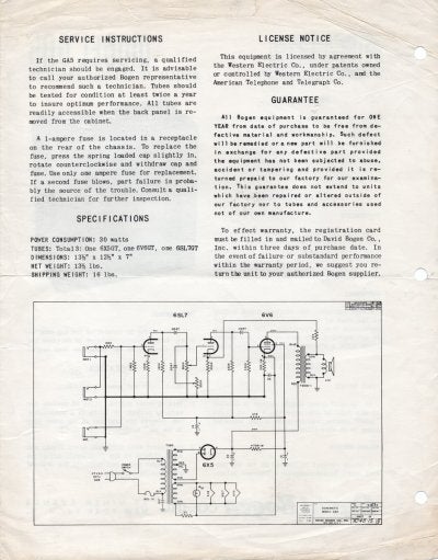

My very first guitar amp was a Bogen from the 1950's. It was basically a tweed Princeton. I wish I had been smart enough to hold on to it. Looked like this:
View attachment 977601View attachment 977602
I have this same amp! I’ve been digging and digging for information on it. I’ve found some but I’ve really wanted to find some owners of these amps and kind of make an “archive” of them. They’re such cool rare little gems. They were made in 55-56 when Bogen was moving from NYC to New Jersey and I’m sure because of that they’re numbers and information are so far and few. If ya have any pics or even have stories Send me a pm I’d love to hear!
