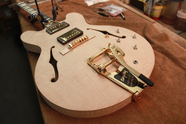

I hope I’m not overstepping, but I have a question about a guitar kit I’m building.
It is an E335 Gibson(?) style hollow body electric. It came with a Bixby B70 style vibrato, but there is no support structure inside the body to accommodate the 2 B70 screw holes. They did drill and supply bushings for the bridge itself, but I’m worried about putting screws thru the thin body area. Is this normal for a Bixby installation?
I saw a product online called the “Vibramate Adapter” but I’m unsure if the Bixby “style” tremolo will be compatible.
I did add a Duesenberg Tremolo to my Ibanez AR63 hollow body with no problems but I think that guitar had some kind of support structure underneath.
The area where the two screws near the bridge need to be drilled just go through thin areas. There’s no heavier wood underneath for Support. I was wondering if I should glue something underneath to give them something to bite on? Mine does have the more support area by the button. There are three screws there.

A: Bigsby, not Bixby.
B: There are various Vibramates for various guitars and various Bigsbys, get the right one for the guitar and the Bigsby.
C: Is it fully hollow? A 335 is semi-hollow so it would be solid under the Bigsby. If it's fully hollow like a Casino yeah I wouldn't screw into that top and I'd be worried about it supporting it. It can be done though. Epiphone Casinos have come with Bigsbys, obviously so have Gretsch guitars.

As Superbadj said, if its a 335 or 335 clone it will have a solid center block to support both the bridge and the trem (or stop bar if no trem). I don't think I would screw a Bigsby to the laminated top of a fully hollow body, altho some hollows (like 175's) have braces that run under the bridge. I would confirm whether it does have a block. Here is a 335 style guitar with the full center block
And with the trem sitting on the guitar. There are two screws that go into the top and two in the tail block.
Try poking a coat hanger into that area to see what you've got.

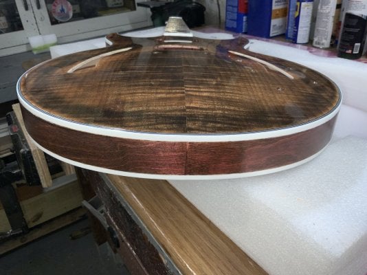

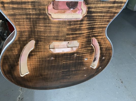

Thanks folks. I checked with a strong flashlight and a mirror, and there’s nothing there but a ‘T’ shaped block that supports the bridge with predrilled holes. There is a small block for the stop tail. This is a “Pango” kit from “GuitarKitshop” and the support has been none existent as if no one has any idea of how they built their own guitar.
I was wondering if there is a way of doing a ‘trick’ like we sometimes do with sheetrock when we try to add some type of support for a patch, sortof like a toggle bolt. I’ve done it by sliding a piece of wood into the hole, turning it so it overlaps the hole and then putting screws into it thru the good sheetrock. I then make a patch the size of the hole and screw thru that to the piece of wood that spans the hole. Works better for me than the other method of cutting away the back part of the sheetrock so the front paper overlaps the hole.
I was thinking I could drill the holes, insert a piece of thicker wood to the underside with glue and temporarily secure it with a screw from the top, using the drilled hole. Once it dries I would have more beef to screw into.

OK, I'll comment once more and then shut up. Have you determined exactly what kind of block or bracing you've go in side that thing. The ad calls it a "semi hollow" and "ES335 style", the correct use of those terms would be the solid center block with kerfed filler pieces on the top and bottom like I showed in my previous post. But who knows what a Chinese copy is. Many hollow bodies have some sort of braces running the length of the guitar as shown in post #9. I've also seen short blocks that don't extend to the tail block.
The top of the guitar is plywood, laminated maple and maybe other veneers. It will be slightly more than 1/8 inch thick. I would not screw the tremolo into just the top. You have some pretty big "f-holes" (except they aren't f shaped), if you determine that there is nothing inside you could laminate some additional bracing installing thru the f-holes and clamping to the top, you'll have to figure out how to clamp it but I think that could be done.
The problem that I am having with all of this is that the manufacture has obviously intended for it to have the trem, there are no holes (or bracing) for a stop bar. Early 335's had trapeze tailpieces and you could fit one to this instead of the trem, but for some reason they felt the trem would be fine.
I think the key right now is to confirm exactly what you have inside.

Since it is in parts right now, just stick your phone or a mirror in the bridge pickup hole and/or F-holes and look toward the lower bout of the guitar. You will either see a block of wood in the way, or you will see to the tail block with only some braces in the way.
If there is a block visible, you need to MAP it to see if it is full length or not. It may only be under the bridge section. What I would suggest is to put some low-tack tape on the center of the body and use a cheap STUD FINDER to map where the block is and isn't. You just slide it around and where the "stud" drops off is the edge of the block. see if the block extends to where your screw holes will be for the Bigsby.
If the block is not going to help with the screws, you can still drill and screw into the plywood to mount the Bigsby, but it just won't be as solid. There is constant up-force at the tension roller caused by the strings, which isn't likely a problem if you drill and screw correctly. But really wailing on the whammy bar over time could pull out the screws. If screwing directly into plywood only, I would consider gluing the screws, or consider a B3 style.

Thank you folks. I have confirmed that there is only enough block supported by that 1x1 piece that will accept the bridge screws. There is no other blocking other than for the strap button and the tailpiece flap.
I think I’m going to use a glued ‘wood toggle bolt’ fabrication with a couple of small discs of strong wood that will withstand the grip of the vibrato screws, which are not overly large to start out with.

The point of the arrow shows the lowest extent of the wood underneath. There’s nothing else. I’m at a point where I do not want to spend any more money on this, I don’t think a vibramate will help. I have a variety of clamps and other sources to add wood to the area.
