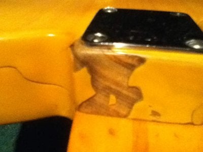

In the last couple months, I've had two big pieces of nitro just pop right off of my 52RI. Ive played it a lot over the last several years.
Now there are big cracks, and while I'm playing, if I touch it the wrong way it catches under the crack and chips off.
Anything I should do for the remaining finish, or unfinished wood when a chip breaks off? The last one was about the size of a silver dollar. One part of me likes it, the other doesn't.
Thanks!

Unless the finish checking/falling off is somehow interfering with the guitar's playability, no. Leave it alone.
That's what nitro finishes are supposed to do.

actually "Big Chips" suggest something other than Nitro Lacquer.... It is too brittle to come off in "Big Chips".. unless the primer/sealer coatings were not compatible.

A good nitro finish should show wear and checking fairly quickly compared to a poly finish.
It shouldn't have big hunks popping off unless the wood wasn't prepared right or the finish wasn't applied correctly.

Yes^^^. There were some Martin flattops that had that problem on neck finish a few years back. Big chunks fell off & you could then peel more.
Only nitro finish I've ever seen let go in 'chunks' thru dozens of 'em I owned was on a '50s Gibson flattop. It had heavy-duty checking + signs of being hung in a barn for years so it had an excuse.
That shouldn't be happening to your AV52.
Stubee
Jan 22, 2007
13,717
Mid-Michigan
It's a well established fact that the '52RI has a more or less thick polyurethane undercoat. THAT can certainly come off in big chips.
I'd read about the AV52 thick finish chipping before but didn't think it came off as 1955 is describing = you can peel it, unless it was a bad one. The AV52 I had didn't do that. My AV62 has a finish crack by the back plate & a flake came off but that's it. I think my '62 finish is very thin, though, compared to a '52.
Well, if a cracked finish AV52 will then keep falling off in chunks if you catch an edge, and this is normal, I stand corrected & surprised.

No, no. I'm not saying it's normal, just that it could happen with poly finishes as opposed to nitro - especially if it gets a dent. Poly cracks in a very different way than nitro.

Wick superglue under the remaining finish to keep it from
going further.

Is it an AVRI 52, or a newer AV / Pure Vintage 52 (these came out in 2012)?
Someone else here had chunks coming off an AVRI 52. They have a thick finish.

Mine's a 2005 52RI American. Will try to take a pic soon. Great help everyone!
1955
Apr 10, 2010
13,590
The latest two chips
And here's some of the regular wear/older chips:image-944253006.jpg
image-3487099164.jpgYou can see how the crack is getting so it will peel off even more:image-544603696.jpg
