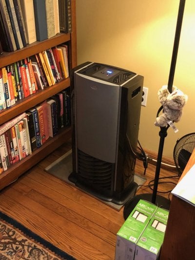

I need to get a room humidifier. We have a whole-house one, but it's just not good enough. I need to get one for my guitar room. What is the best type for this purpose? I have researched this a few times before and always get confused. Cool mist or warm mist? Evaporative or ultrasonic? I want something fairly large so I don't have to refill it constantly. Quiet, because it's my practice room. Relatively easy to clean and refill. Not too godawful ugly if possible. Thanks for suggestions.

OK thanks everyone. Based on a couple very sensible comments above, I went with the Aircare evaporative humidifier. It seemed the advantage of this type are: quiet, no dust, no need for distilled water, no visible "mist" that might turn into condensation. Yes there is a filter to change but that's what allows you to use tap water. The downside is they are bigger so take up more space in a small room. But they have larger tanks so you can refill less often. Actually I ended up buying two, a small one for the guitar room and a bigger one for the living room. We'll see how it works out.

I thought I'd report back, after starting this thread. Went with the Aircare evaporative humidifier. It's pretty big, and has a 2-gallon capacity. On the low setting, I have to refill every 2 days. It's pretty easy to refill, so no trouble there. It is whisper quiet. You can set the desired humidity level, and it tells you when it's empty. I have it in a medium-size room, and running continuously on low it raises the humidity in the room by about 10%. If I turned it up higher it would raise it more, but then I'd have to refill it every day instead of every other. The built-in hygrometer is misleading. It's measuring the humidity at the unit itself, which is skewed because that's where it's pumping out the humidity. I put a hygrometer on the opposite side of the room and it was way, way less. Still more than the rest of the house. I have no idea how the filter life will be. My water is very hard. All in all I'd say I'm satisfied, and I would buy it again.
