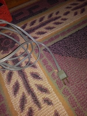

Hey guys,
I just picked up an old Beltone AP-12 ('58-'62) amp at my local music store. It had been sitting there for about 6 years on consignment, but nobody was interested. So I finally broke down and bought it. The pots were slightly dirty when I first played it, but when I took it home and cleaned it out real good, it sounds immaculate! Perfect amout of tone and you really get that 60's rock and roll sound. I am still faced with a few problems, however. The tremolo is not working at all, and the 1A fuse is missing. The on/off toggle also does not function. It looks like it had been modified, since the power chord does not look original. I think the on/off switch may have been bypassed for reasons I have no way of knowing. The speaker has likely been replaced since it is not deteriorting, like one from the 60s would be. I suspect that a fuse might be blown, therefore resulting in the tremolo not working (since this amp is fueled by all tubes) I'm just wondering if anyone here remembers these little amps and might have some suggestions on how to get the tremolo back in working order.

Replacing/re-connecting the switch and fuse, and changing the power cord to a grounded one should be done before you plug this amp in again. If you don't know how to do that, take it to someone who does.
For what it's worth, the fuse being blown and the tremolo not working are two unrelated conditions. If the fuse is still connected properly, and it is blown, then the entire amp should not work. Since the amp makes sound when plugged in, then the fuse is not blown, or is not part of the circuit anymore.
If the fuse, like the switch, is no longer part of the power transformer's connection to wall voltage, then it wouldn't matter whether it's blown or missing or made of green cheese.

There is no fuse in this compartment. It is likely that several modifications have been made to this amp. I am not sure if whoever decided to make these modifications meant for the fuse to be left out.
This is the power cable

That is not a schematic. That is a tube chart. The power cable is an ungrounded power cord and for safety should be replaced with a 3-wire grounded AC power cord that is installed by an experienced tech. Whoever bypassed the fuse did NOT a know what they should have been doing. This indicates that whoever did it had very little experience an d therefor no regard for the safety of the amp or anyone who might use the amp.
Again, imho, you need a tech.
Yeah. It looks like a chord off a vacuum cleaner or something. I suppose I'll never know why this person decided to modify this amp to begin with. I've never been zapped or anything, but I don't trust that it is hazard-free.
"No switch and no fuse is potentially trouble".
I think these both were wrongfully bypassed, and I've no clue why anyone would want to do that.
