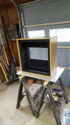

thanks all... I guess I was not clear in the question. I plan on loading the baffle from the front and do not want a surround- or trim. I am going for this look...thanks

I re-read your post, and I guess a couple of us did mis-read it the first time around. I was thinking clearance on the front, between the grill cloth and baffle. Not baffle+grill cloth clearance to cabinet.
The clearance you need should be about 1/8" for it to be tight. Go 3/16" and you should probably have an easy fit. You could simply fold over the grill cloth you have and measure it... Then give it a touch more, because you won't get it super tight when stapling it in place. Plus, the staples won't sit flat.

I have done several of my own baffles and I use digital calipers to measure the thickness of the grill cloth, (and piping if using) then add 1/16”. Take those measurements and subtract before cutting your baffle board. After you cut the baffle board, cut a few small pieces of cloth/piping and dry fit it before you start stapling the grill cloth on.

If you work on a baffle 1/4" narrower/taller than the cutout dimensions (ie length and width of the opening before tolex) you will have a good fit with a small amount of clearance. I have cut spacers to position my baffles in this way when I am fixing them into place and they work out perfectly.

When I built my Tweed Pro cab, I waited until the cab was complete before cutting the baffle board. Then I dry-fit bits of tweed (for the cab) and grille cloth (for the baffle wrap) to act as spacers, to determine baffle dimension. Basically, I wanted a snug fit.

thanks all. Now I have a plan. Going out to final grain fill, and hope to have color on late this afternoon weather permitting. I'm going for a translucent butterscotch lacquer.
I'll cut and fit baffle and grill cloth to fit after.

View attachment 682278 thanks all... I guess I was not clear in the question. I plan on loading the baffle from the front and do not want a surround- or trim. I am going for this look...thanks
That's what I thought you were asking. I'd go with about 1/4" overall, (1/8" all around) This will be a close fit. A little more for tolerance maybe, 3/16 each edge max.
