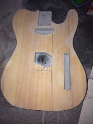

I'm thinking, now looking at it, that the gold, while nice, isn't very atomic age. While nice, not fitting the build.
VeryExciting
Nov 30, 2013
30
Albuquerque
VeryExciting
Nov 30, 2013
30
Albuquerque
EricIndecisive
Apr 14, 2009
221
Western MA
Not sure what wood.. sanding down is the worst! Those other guitars looked more steam-punk to me.. when I think atom-punk I think all of the sci-fi type looks. Radioactive tubes / canisters. Antennas. Ray guns. Swooping, aerodynamic shapes. I think the coolest inspiration for this would be from cars & pictures of ray guns. Definitely like the surf green idea though ;)
