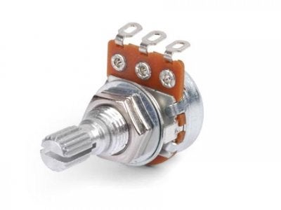

    You often see that one of the first courses of action for a lower end guitar is to replace the cheap "mini" pots with good, full size ones.
    First let me say that I have learned my lesson with cheap pots ;) However, I have had great success with CTS, Bourns and Alpha pots, so I stick with those. Alpha makes mini pots and they seem to be of the same quality as their full size ones.
    I'm assuming the "all mini pots are bad" statement is a stereotype and that there should be no issues with mini pots from a reputable manufacturers.
    Can anyone comment of their personal experience with "good" mini pots? Especially Alpha?
    Thanks!

    I commented on this sort of thing in another topic where I got curious and looked up the spec sheets for different manufacturer's offerings. Basically, the stated specs for both small and large pots is 10,000 to 15,000 rotational cycles minimum. True to @radiocaster's observation, the 24mm Alpha pots are rated for fewer minimum cycles than the 16mm. Bourns gave a maximum of 500,000 for their 24mm pots, but no maximum for their 16mm, implying that anything over 15,000 is a crap shoot. Interestingly, CTS has a line of "better" quality pots that are rated for a minimum of 100,000 cycles, but only in 24mm. Conclusion? Both types are rated to at least give you a minimum service life, but the 24mms are expected to last longer than that. Think about how many times you actually twiddle your knobs every day or week and put that up against the stated minimum lifecycle... YMMV, but I think it'll be quite a while before you even begin to wear out your mini-pots. ;)

    @radiocaster Thanks for elaborating. Now that you mention it, I have noticed scraping with some cheaper pots. I just threw out 20 or so really cheap ones I got in bulk - so cheap that it was worth a shot, or seemed so at the time. Way too much drag and noticeable scraping. You get what you pay for! I can't recall if I have noticed this with Alphas in the past, but not with any new Alphas I have right now (just checked :) ). Interesting your observations with the Bourns pots. I thought they were considered premium - I can usually find CTS pots cheaper than Bourns. As such I have not used Bourns pots much. FWIW, I always use a heat sink when soldering pots now - I have ruined cheaper pots in the past with too much heat.
    @edvard Thanks for the specs - no, I'll likely not see a failure any time soon :) The mini Alphas are convenient at times, so given the consensus here, I'll likely use them more often now.
