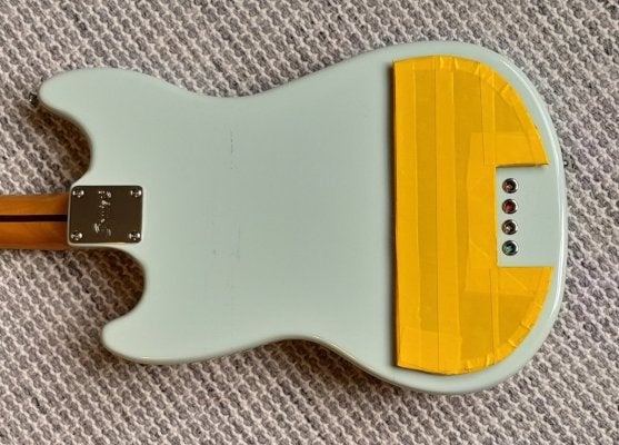

Anyone put a Mustang neck on a P of J body?
  • Thread starter Telenator
Telenator
Vendor Member
Sep 19, 2005
16,577
Vermont
The neck dive must end!
I love the short scale but cannot play a Mustang Bass on a strap while standing.
I have considered the other solutions but keep coming back to the same thing.
THE BODY IS TOO SMALL, TOO THIN, AND TOO LIGHT!!!
It's just an inherently bad design that Fender appears oblivious to and could fix by just making the body thicker or heavier.
Anyway, I'm considering two solutions to this issue because I can't play a longer scale, (arthritis,) and I'm just one of those people who has to fix these stupid things once and for all.
1) I modify a P or J Bass body to accept and tune with a Mustang neck.
OR...
2) I take a Mustang body and attach a 1/4" steel plate to the back of it way down by the lower strap button.
This Bass plays and sounds so good, I can't believe it's such a nightmare to play standing.
Anyone have any success with something like this?

Success!
I bought 4 pounds of lead sheet and used about 3 pounds of it.
I made a large lead plate and covered it with duct tape.
Then I attached it with velcro.
Sits perfectly on the strap now. Photos later.
Out the door to an audition with toxic, eco-hazard bass!

And this is what 3 lbs of lead looks like when it's velcro'd to the back of the bass.
I wrapped it in yellow duct tape so that any "wear-through" spots will show up.
The added weight actually seems to have improved the sound as well.
It's no heavier than a full size bass now, and it balances beautifully on a strap!
